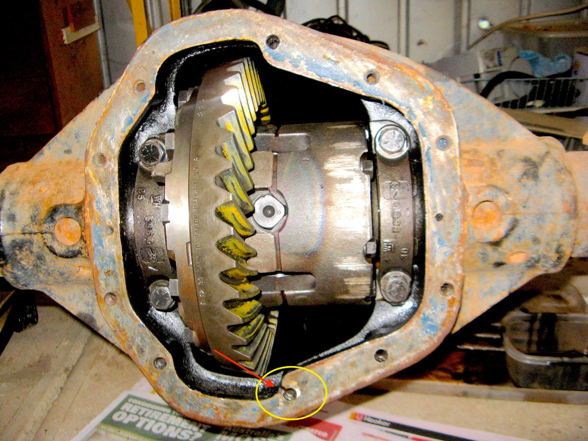

10 Apr 2018 11:06 - 10 Apr 2018 11:10 #44
by dandjcr
dandjcr replied the topic: Dana 70
Yes, our Oka had a "diff event" before we bought it.
You could drill though the diff cover bolt hole (in yellow), as an occasional side-of-the-road drain hole. Need to drill a smaller diameter than the bolt thread so the bolt can be reused (with copious gasket goo).
But is this a drain slot (red arrow) that's been cut? Not on our front diff.
Either would allow most of the water to drain out if necessary
Last Edit: 10 Apr 2018 11:10 by dandjcr.

11 Apr 2018 12:28 #45
by OKA in Africa
Thank you and best regards
OKA #327 in Africa
www.oka4wd.com/forum/members-vehicles-pu...47-oka-327-in-africa
OKA in Africa replied the topic: Dana 70
The option to make a "drain hole plug" via the threaded drill hole as indicated by David is interesting.
Considering all your input I might just replace the broken magnetic ring with a magnetic plug at the filling hole. I assume as well that the diff oil is sloshing around so much that the filing7glitter would be still collected there.
OKA #327 in Africa
11 Apr 2018 16:37 #46
by dandjcr
OIA, the position of your magnet was above the filler plug anyway, so it relied on oil sloshing around to collect iron filings.
So a magnetic filler plug should work just as well.
