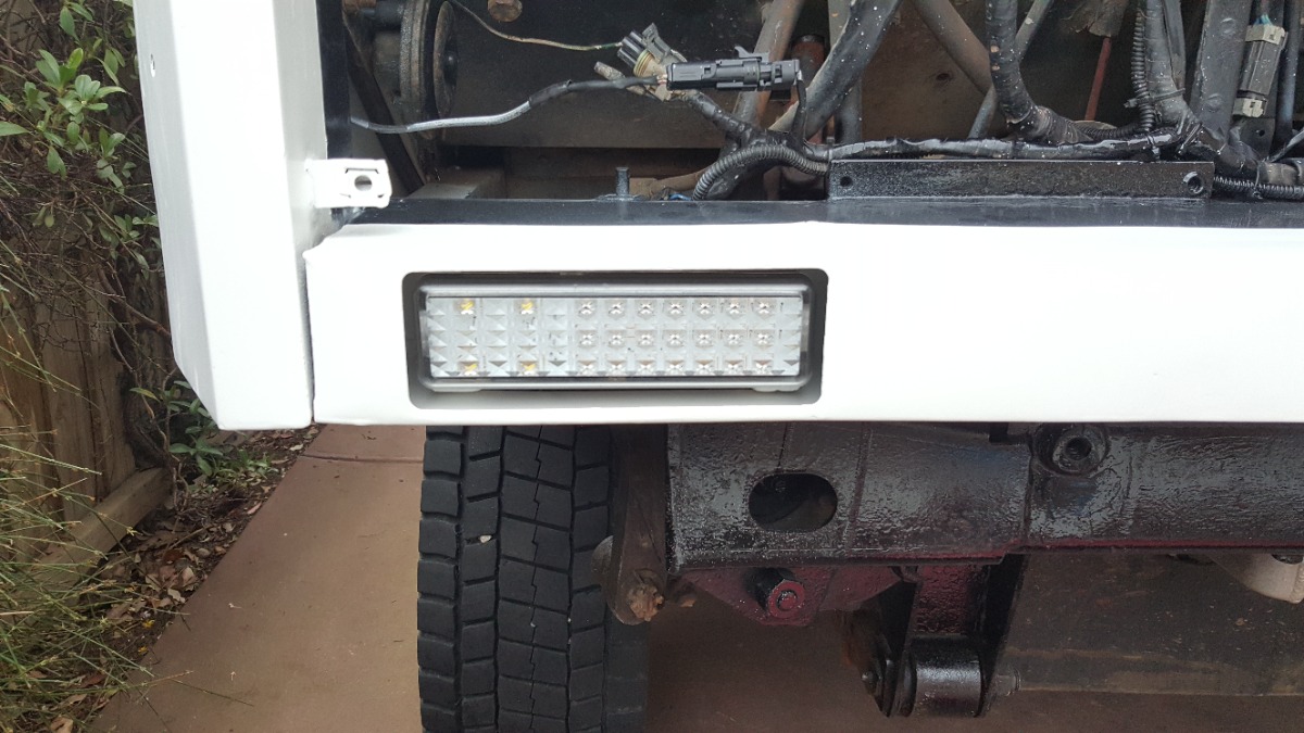

Which rear light clusters did you choose?

Thanks David I used 80 triple series LED Autolamps part no 80BARWM.

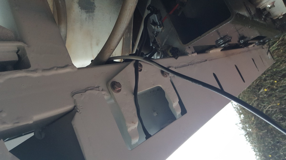

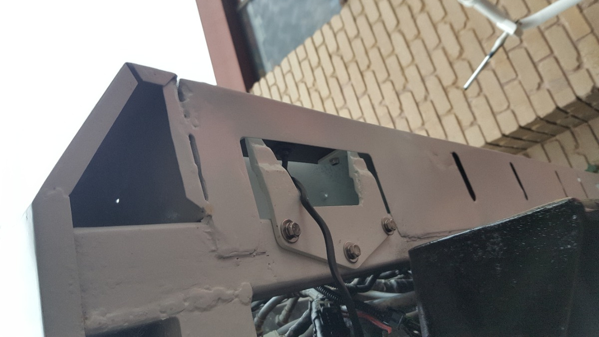

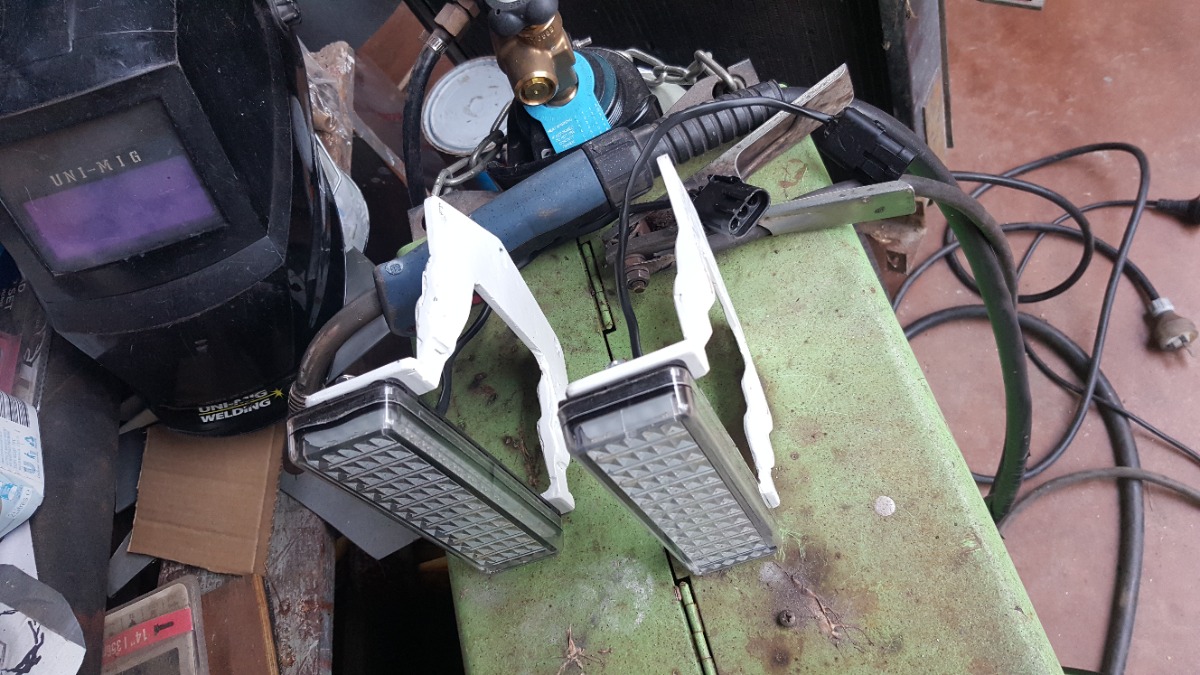

Decided to use lockdown to give the OKA its 5 year nose clean....
As per advice from the esteemed late David Ribans (above) I decided while I was there to modify the XT indicator mounts to fit new led autolamp 175aw/2 recommended by Ewart and Outback Jack on the forum under front indicators here .
original lamp and mount
new led lamps and mounts
Rick Whitworth:  OKA XT 149.    Digital Twin.   Loaded 4x4.
Rick Whitworth replied the topic: Front Indicators
dandjcr wrote: Ewart, I tidied up the thread removing duplicated posts.
LED flasher probably required if you changed the rear indicators to LEDs as well. The ADR for indicator lights is 90 +/-30 flashes per minute (Appendix A section 6.5.9), although 80 seems to be a common rate.
XT front indicator lights have a slightly different bracket. Easy enough to make up a new bracket, probably rusted away anyway in that area:
