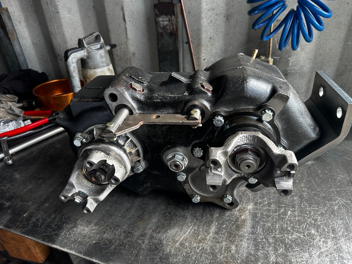

Talk to Paul or Dean about the gearbox selector linkage with 2 bolt holes. New selector linkage only has a single bolt hole. I added the smaller second hole because there was a second hole on the gearbox side of the linkage. The single bolt arrangement was loose as buggery. I paid for a new smaller hole to be 'machined' in the selector arm so it was on the centreline. There was no meat left so they 'made' a slot.
Refit putting the bigger bolt in first.

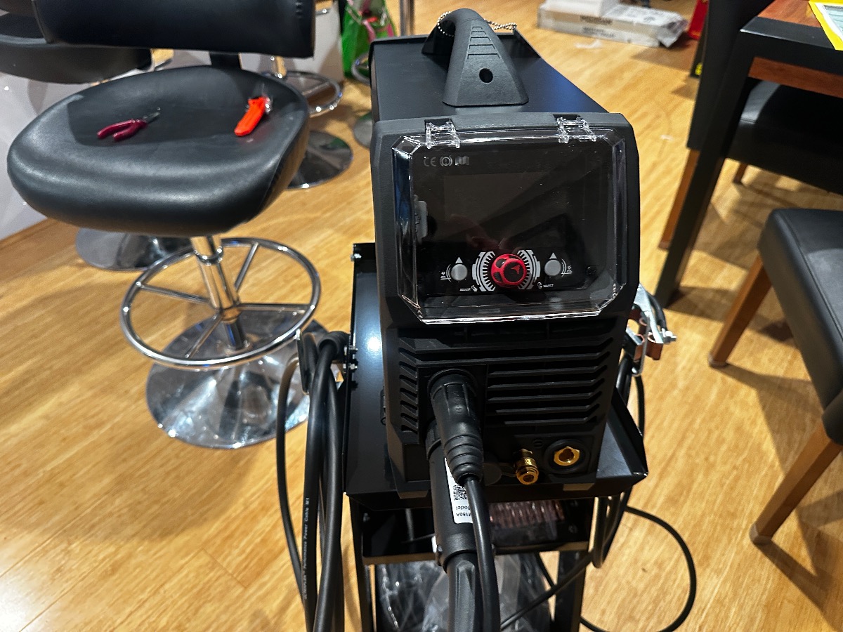

251 will slowly come back to life, went and bought myself a new welder today, as I anticipate there will be a bit of welding involved along the way and my old mig was absolute crap!

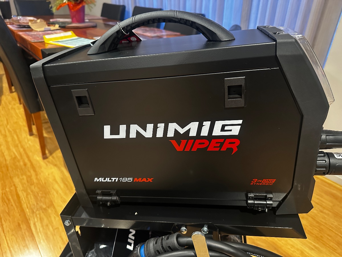

It’s nothing too flash, but much easier to use than the old piece of garbage I had. It’s a Unimig Viper Multi 195, Mig/DC Tig/ Arc.
Very easy to get setup for whatever needs welding. Does it all for you after inputting your parameters. I’m going to grab a gasless wire nozzle for it, as I will rarely use gas.
My welding ability is not the best, but I think I’ll be much better at it by the end of this project!

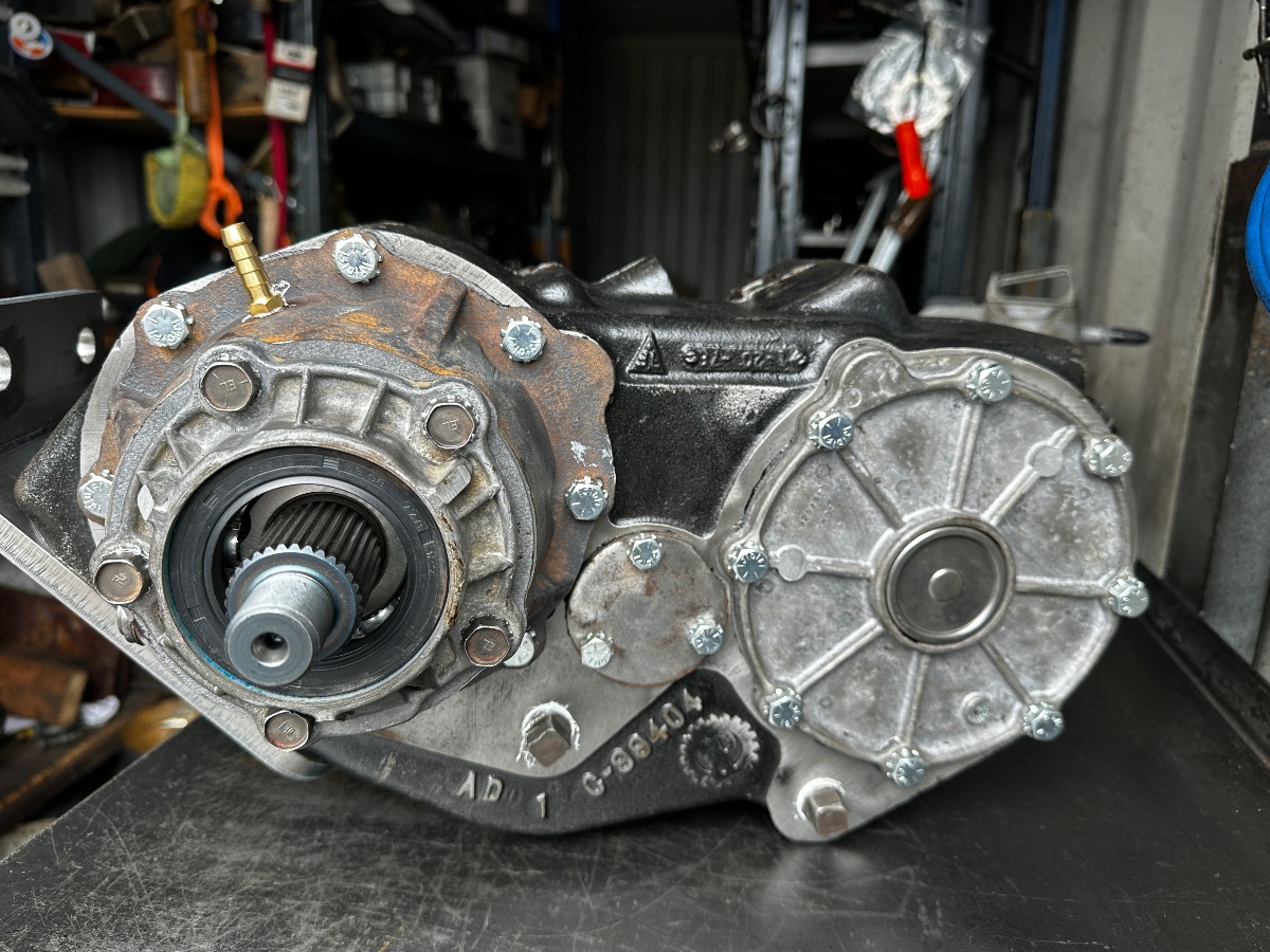

Rebuilt NP205 bought from East Coast OKA spares. I’ve also elected to go with a heavy duty rear output shaft.
Going to pull the Rockwell out this weekend and Paul will send me the NP205 so I can fab up some mounts prior to pulling the engine etc.

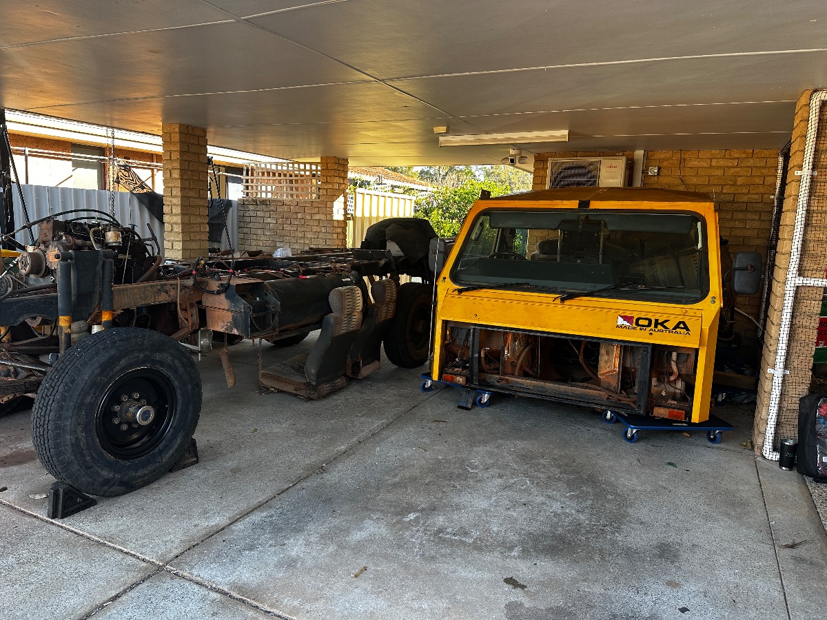

Pulled the cab off on the weekend, all went according to plan.

I love my unimig machine makes it so easy. Do yourself a solid though and forget the messy spattering gasless stuff and get an e size bottle of gas from bunnings. 300 dollar refundable deposit on the bottle, 185 per swap for gas and I get a bottle to 1 and a bit 5kg spools of mig wire. So much cleaner, and far easier to weld with.

Dane wrote: I love my unimig machine makes it so easy. Do yourself a solid though and forget the messy spattering gasless stuff and get an e size bottle of gas from bunnings.
The vast majority of my welding will be outside, so I’m subject to the wind most of the time. If I can ever convince the missus to get rid of her 20 years of crap from the shed, I’d have a better place to work! I’ve been trying for 15 years now, LOL

Cab is removed along with the doors and windscreen. I did a botch job removing the windscreen rubber, mainly because I didn’t realise it was a one piece seal, I thought it was an inner and an outer rubber. Lesson learned!

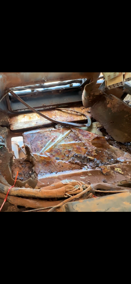

There is a fair bit of corrosion around the windscreen channel, it looks like a small surround section is welded in there. Any advice on the best way to deal with this? Is this a part I can buy? I’m not sure how I’d get the corner curves to DIY.

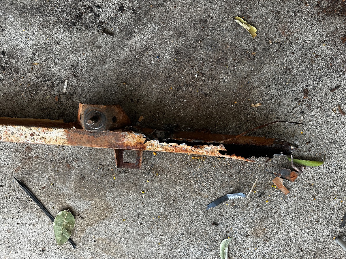

Also removed the front crossmember that is well overdue for replacement!

Don't despair about that seal, it isn't all that expensive and really should be changed as it will have deformed with the rust that was in the channel on that truck.
Those door bolts are brutal ! The thread that sticks through the frame gets crud on it and hey presto you break the heads off. I took 3 days to get them out of the driver door on 173. When refitting use the shortest bolts possible and coat in never seize, then ser a reminder in your phone to remove, clean, re never seize and install every 6 months to prevent it happening again. I have heard of a mod to use a bolt in place of the Allen head bolt and need to talk to Dean about it when I'm there next.
The windscreen seal channel is an angle welded in place. It is an odd size and not easily bought. The bend is not easily done. It comes in two pieces. They whole channel can be purchased through your oka parts supplier. The OKA parts suppliers can't actually get any made at the moment but have a few in stock. Some guys have made their own solutions but to my knowledge haven't had trucks on the road for real world testing.

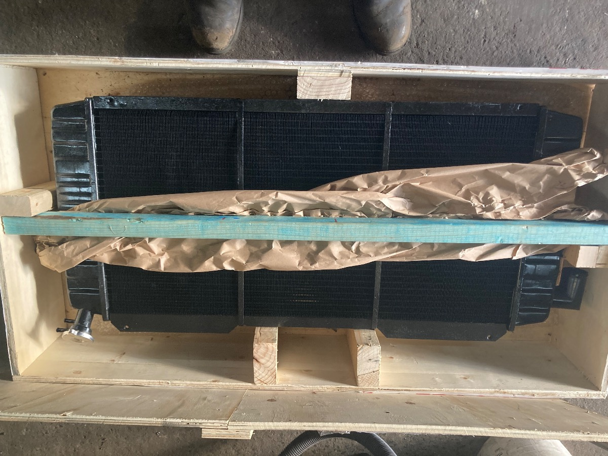

Hopefully Dane can sort out the heater core and evaporator. I sent the radiator to Paul and Ian and had it redone as a 5 core, should do the trick.
