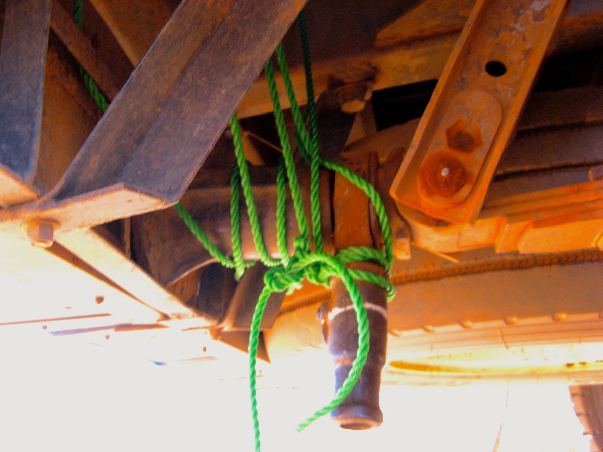

I jack under the spring mount when possible, on the axle tube between the U bolts using a jack with a saddle, and use axle stands for additional safety. Very rarely can you jack under the chassis, it's too far from the ground.
You also need a heavy duty jack 6-10 tonnes capacity preferably, Normal car jacks (1-2 tonnes) are not adequate for a 5+ tonne vehicle.
If you have or plan to get a Hi-Lift jack, which can be very useful for getting out of a tricky situation, there are jack points on the front and rear bullbars, if fitted, but I found them awkward to use effectively, and it's difficult to raise a wheel off the ground using them. So I added hi-lift jack points to sides of the bulbars, see here. .
You can also lift a wheel using a hub adaptor which fits over the hub and can be raised using a bottle or hi-lift jack (handy for debogging or when you can't get a jack under the axle), but then you can't remove the wheel without using an axle stand and lowering the jack.

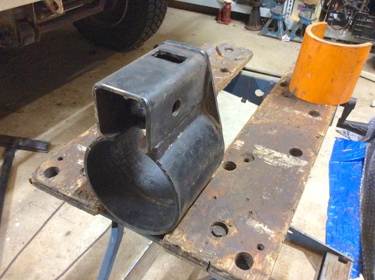

OIA, here's a link to a better version of my Recovery Gear article. Damn you Photobucket!
I had one of the red hub adaptors you mentioned but it failed at the worst moment during a debogging exercise, couldn't support the weight and buckled. Fortunately there was enough meat showing so my screw jack still worked. But I also needed my hi lift jack as well.
After that I got a much stronger hub lift adaptor (made by a mate of mine, thanks Dave and David) along the lines you proposed. The orange packing section allows it to be used on the front hubs as well as the rear.
The square receiver fits the Hi Lift jack (in pieces being overhauled) and also a standard 50mm tow hitch so I can also use normal jacks.
I agree a high lift jack does require a LOT of effort to operate using the Oka jacking points but is a bit easier with my side jacking points. And you do need a solid base for soft ground.
Do you have dimensions? ID or OD of tube and thickness?

Holmz wrote: Do you have dimensions? ID or OD of tube and thickness?
Holmz, the rear hub is nominally 120mm diameter and the front is 105mm.
The hub lifter tube has ID of 123mm (probably a 5 inch stock size) and it's all 5mm thick. The packing piece was chosen to fit the front hub.
The square tube is 55mm square inside.
The length is 120mm and you don't want it too deep, you need the jack to lift as close to the wheel as possible. A purist would probably cut slots in the rear to fit around the wheel nuts but my old red lifter did that and needed the wheel turned so the lifter was more or less vertical.
The strength is in the quality of the steel tubing and the welding, and if I was making another one I'd fit front fillets like at the rear. Cast iron would not be a good idea...
Note the notch inside the top of the tube for the strengthening rib below the Hi-Lift jack nose to fit, and the slot at the back of the top for the lip of the jack. The hole in the side is for the tow bar pin and can also be used to secure the Hi-Lift jack (probably unnecessary).

OIA, the original design was done by Dave/David in Perth after my red lifter collapsed, but I added the suggestion for using a tow hitch/normal jack as an alternative lifting method to a hi lift jack. In a workshop a trolley jack with enough reach could be used for a quick wheel raising without having to scrabble under the Oka.
There's no technical reason why the lifter couldn't be longer (as it effectively is using the tow hitch method) but moving the lift point outwards would put more stress on the lower edge of the hub unless it was a tight fit, and that might mean fitting and removal would become more difficult (I expect the round tube to be pulled a bit out of shape/oval during a real life operation).
I haven't tried it yet, but I can't see why a high lift jack couldn't be used sideways under the tow hitch extension, although it would be less stable.
Also note that the front hubs are smaller and with thinner walls than the rear (I'm told, haven't checked that) and therefore more susceptible to stresses. Being bogged is bad enough but breaking a front hub would be worse.
But no I haven't had to use it in an actual bogging situation yet but I have tested it in my shed and it worked fine. In our real bogging experience I used the original hub lifter/screw jack and hi lift jack both at the same time to alternately lift the Oka body and wheel, (which is why I needed the lifter to be useable 2 ways). That spread the load/reduced the stresses quite well on jacks and operators, although soft ground was a problem (but I guess you never get bogged on firm ground).
No other photos yet, but once I get my hi lift jack back together I can take some. I put the basic lifter dimensions in the above post for Holmz, what additional dimensions do you need? The cutouts/slots will depend on the jack model and you could probably think of some more adornments, such as a bracket to attach the lifter to a wheel stud(s) for stability and a flat base on the bottom. Then you could jack directly under the lifter for more lift, although top lifting (pulling up) is safer than pushing.

Don't know Holmz, I'm not a metallurgist and only an amateur welder.
But the whole weight of one corner of the Oka (1-2 tonnes) will be hanging on the welds so they need to be strong. Mine was designed and built by a professional welder serving the mining industry, and who knew exactly what it was for.
The lifter could be reinforced with a strap welded around the whole thing but with professional welding that shouldn't be needed.
