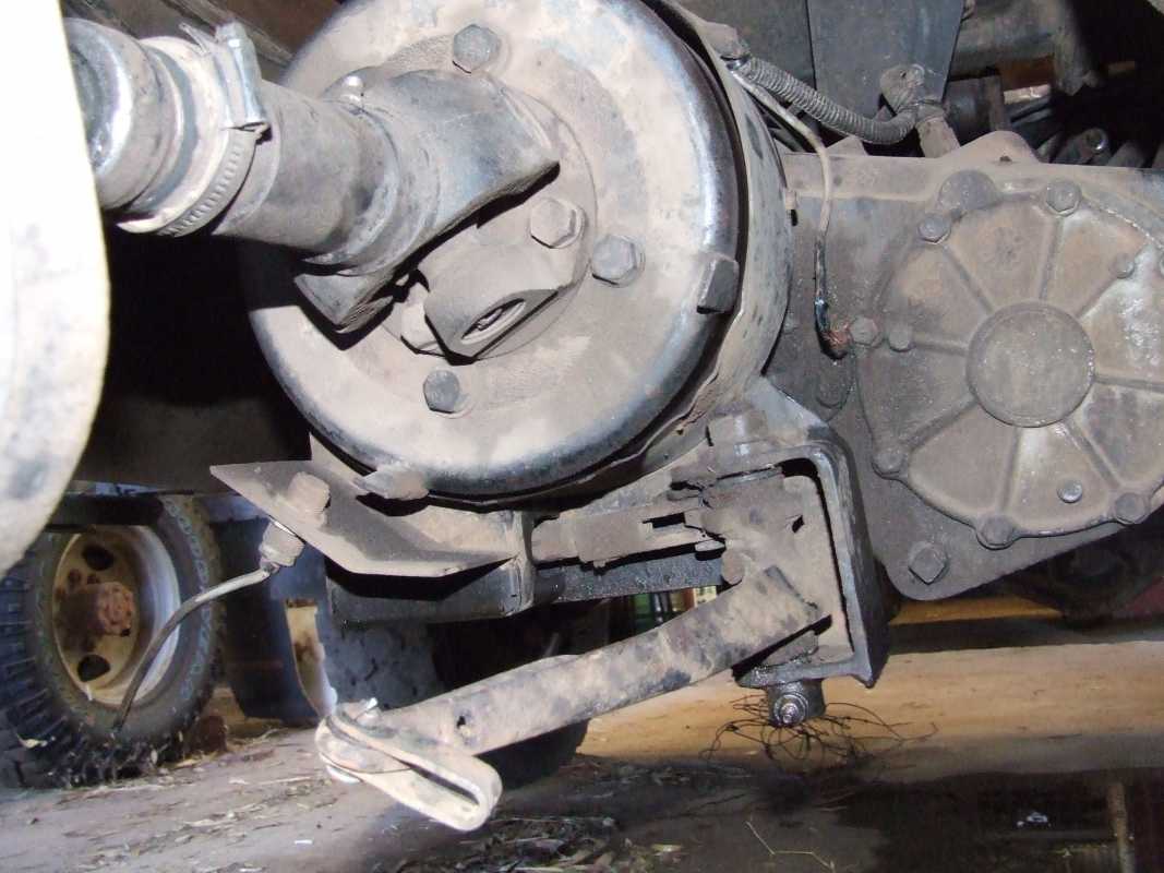

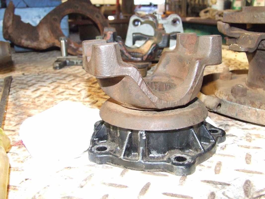

5 KG of crap hanging off the output shaft.
LT don't unbolt, toss the whole T/C in bin!!
XT
this in what is meant to be there

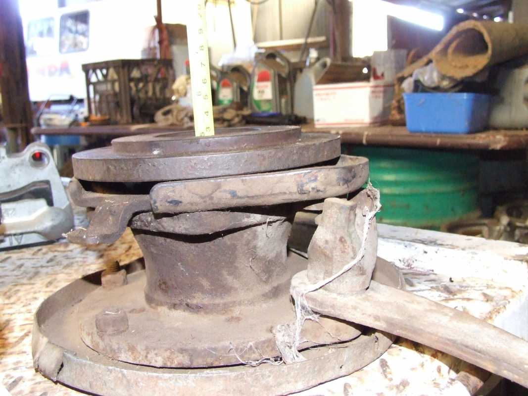

+ drum, aprox 5 KG on OKA
standard 2" OKA 4" & 5KG leverage.
all hanging on 5x5/16 bolts & output shaft!.
when you can jiggle the tail shaft up & down, the needle rollers have collapsed between the input & output shafts. all so causes input shaft breakage.
*5 KG of crap dancing up & down way out back amplify the problem.
*lack of lubrication is major cause
the only time the needle rollers rotate is in low 4WD
2WD 90% use, input & output rotate together
4WD high, same, same
90% of the time the needle rollers are chattering away down the road not turning thus no lube!!
just like a king pin bearing!
finally you put it in low 4WD ? rollers collapse.
solution
*get rid of 5KG of crap of the back
* use low 4WD DAILEY
you don't need to engage hubs
when you back in the shed, setting up camp, ect ect, any slow moving use it
this gets oil into the needle rollers & moves the ware spot.
that is my 10 cents worth

in the US I have A 10" stainless disc park brake being tested .
the disc flange will fit standard np205 seal , tail shaft will need 2" added.
will work with OKA h/brake cable.
