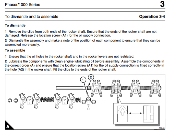

Just took the rocker cover off in search of a way to stop oil leaks and found a bolt lying in the oil luckily hadn't fallen down a pushrod hole. The manual says it is the setscrew det2231236 and should be fitted correctly in the rocker shaft. Does anyone know info. Such as loctite to prevent rattling off, how tight, its purpose?

Hi Peter I did pull all mine apart some time ago and if it is the one I am thinking of it is important as the oil flows through there to lube the rockers and does have a rubber seal so if not installed correctly it has the potential to leak oil and reduce the supply to the rockers. On mine there was no loctite and undid easily I have just looked up manual but no settings.

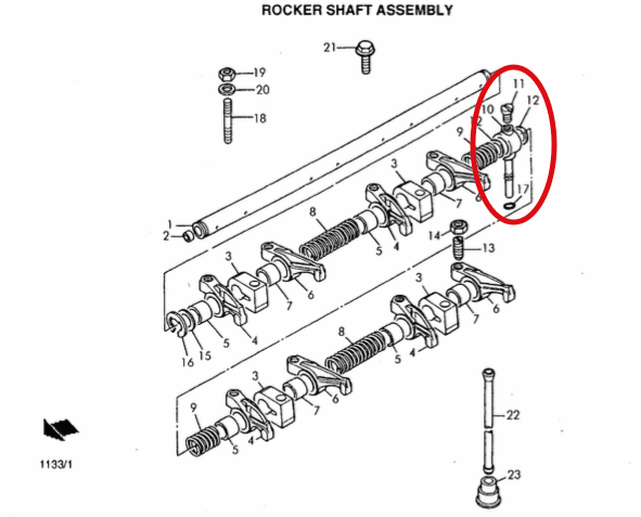

The offending screw is item 11 on this diagram.
In another Perkins manual it's shown as a "location screw for the oil supply connection" and engages with a hole in the rocker shaft, so it is important.
There's no torque setting but since it's quite a small screw, a torque of 10-15 ft-lbs should be adequate (others will no doubt correct me).

That's exactly the one David. I assume that the rocker rod rotates to find hole.
09 Oct 2016 13:07 #7
by mort
mort replied the topic: Rocker cover/inlet manifold seal
Yes peter it rotates easily
