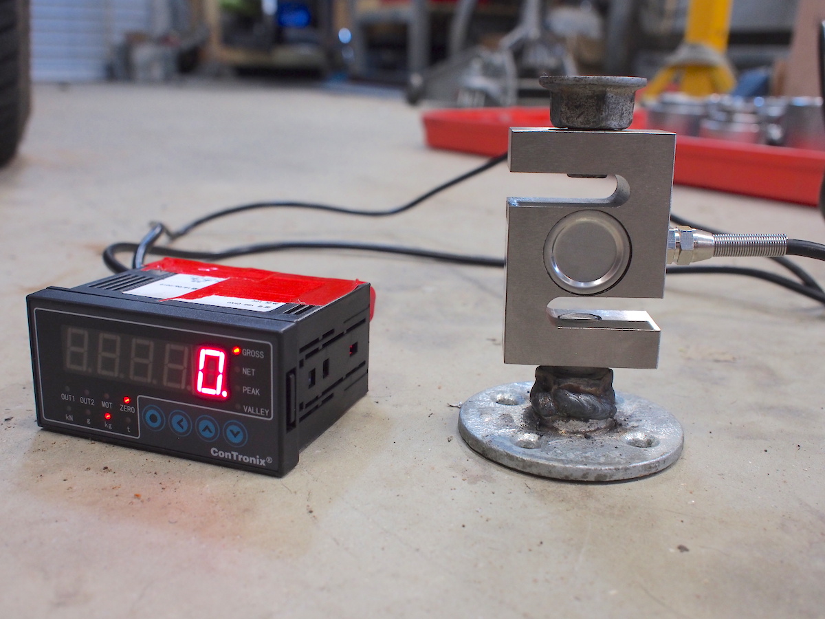

For those that are interested in weighing their Oka or in fact any large object you can buy a couple of items on ebay that make this possible for not a lot of cost. I saw these on the Landrover forum along with the attachment to allow the sensor to be used.
You need a Load Cell Indicator Display
and the bit that actually measures the load. They are available in a variety of sizes, either a 3 Tonne or 5 tonne sensor would work for an Oka.
The Load cell weighing sensor are available in a variety of sizes, either a 3 or 5 tonne would work for an Oka.
Load Cell Weighing sensor
You then need to make the attachment to allow the sensor to be used with a jack under the vehicle.
21 Jul 2019 03:48 #2 by Tony Lee
Tony Lee replied the topic: Weighing your Oka at Home
I would have thought that at least one of the "adaptors" should be more of a point contact to avoid any possibility of sideways or bending forces

Tony they were only weighing Landrovers, we would have to be a bit more careful with the weight involved in weighing Oka's I'd reckon.
But a relatively cheap way of being able to weigh a vehicle at home, although not as cheap as using a set of bathroom scales and levers like this www.robgray.com/ontheroad/wothahellizat/....php#bathroom_scales
