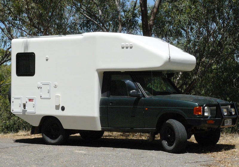

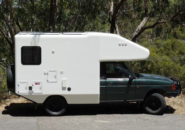

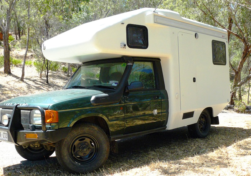

If you have the time, you could do what a friend did.
He made all the sandwich panel himself by laying it up wet-on-wet and vacuum bagging it piece by piece on his shed floor.
Every piece was custom made in terms of glass and foam thickness and he made some very light stuff for the interior furniture.
Then he hand built each sheet join to make a radiused transition.
The awning is recessed into the wall/roof join for protection.
Despite appearances, the vehicle is a long wheel base Defender.
More skill and patience than I will ever have.

28 Jan 2026 11:16 #29 by mat-with-one-t
mat-with-one-t replied the topic: Does anyone have the original camper body and pop-top dimensions/drawings?
That looks like amazing detail and effort. It reminds me of an Earthcruiser build (recessed awning, rounded edging etc. Very nice. He must have patience and dedication - he drives a Defender....
I'd (I'm afraid) never have the time/patience/space/skill/wherewithall to make panels. I've eben seen a video series where someone made ones with carbon fibre layers. Very cool.

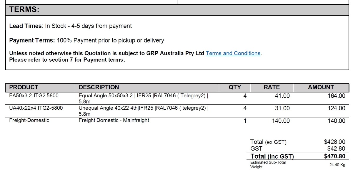

02 Feb 2026 12:35 #36 by Peter_n_Margaret
Peter_n_Margaret replied the topic: Does anyone have the original camper body and pop-top dimensions/drawings?
I have a quote for some FRP pultrusions from GRP Australia in Banyo Qld.
4 of each, Equal angle 50 x 50 x 3.2mm and Unequal angle 40 x 22 x 4.2mm. Both 5.8m long. plus freight to Adelaide freight depot.
Better than I expected. They will still need to be painted.
The following user(s) said Thank You: mat-with-one-t
