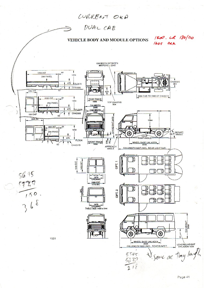

Does anyone have the original camper body and pop-top dimensions/drawings?
24 Jan 2026 10:29 #1 by mat-with-one-t
mat-with-one-t created the topic: Does anyone have the original camper body and pop-top dimensions/drawings?
Hi all. I'm still in research and learning phase! I am looking at a single-cab option with an original camper body and a pop-top.
One concern is that the original camper bodies are steel and may be too unnecessarily heavy. In modern approaches, many seem to use sandwich paneling (such as from Vanglass) often without any frame at all. Another option (as I have a mate who can do so) would be to replicate the original steel frame in lighter aluminum, then skin it in aluminum and sandwich panel.
Another option would be to ignore the original camper body and just build a box from scratch. I do like the lines of the original (following along from the cab), but I am also aware (from helpful people here) that a straight wall is much easier and practical!
Lastly, I'd ideally like the option of 3 rear eats placed behind a crawl-through from the front. Would I be better of with a dual cab for this? It'd be great if these seats could be removable if there is just the 2 of us travelling.
Lots to think about, but I thought I'd start back with the initial question. Does anyone have accurate drawings of the original camper pop-top body?
Thanks everyone! Mat

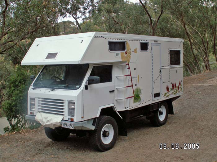

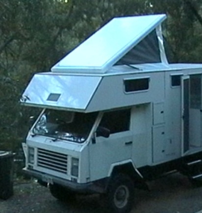

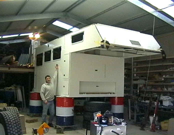

Mat, I built #196 20 years ago. It started life as a tour bus and I ditched the original body. Best decision I ever made. Building the box is the easy part of building a motorhome. It is 2160mm wide. It has 2 legal seats in the rear, either side of the table.
Second best decision was to make it a bed-over-cab. The floor of the N-S bed is the lowest part of the cab roof. This opens up the rest of the living area which changes everything for the better. My biggest beef with most OKA campers is that they are claustrophobic.
I am currently building a light weight version from #077, using 20 years of experience with #196 as a starting point.
Not a lot is changing.
The bed moves forward a tad, and the pop-top over the bed goes and it gets a slightly higher fixed roof.

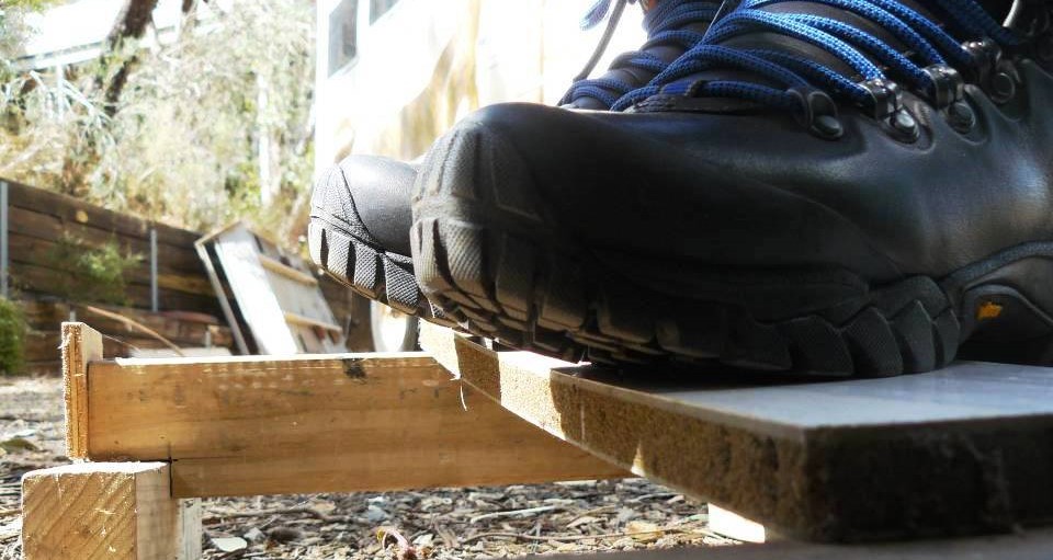

Not a camper, but might have something useful?

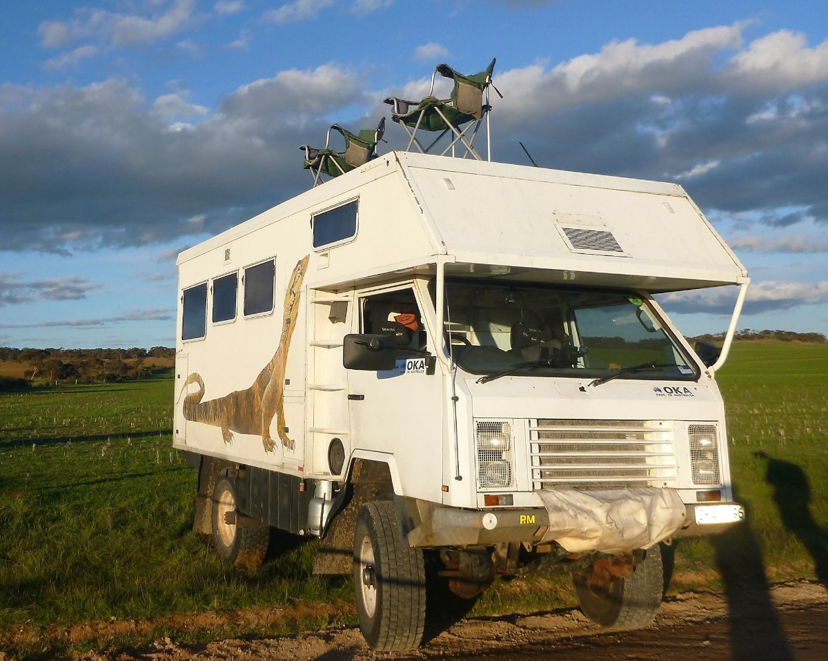

To add to what Peter has said the original camper body from the factory was built on a standard Oka bus/van body with a poptop roof which was a standard design fibreglass poptop made and fitted by Dove campers in WA.
There would have been others that were built on cab chassis by various mobs over the years and plenty converted by owners.

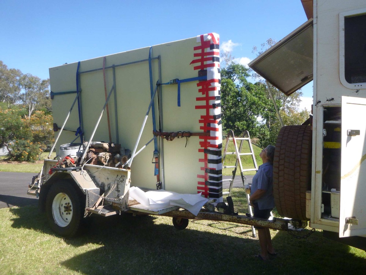

Both vehicles I bought ex factory sheets and cut them myself. Drawing them up on CAD first would probably be better. #196 panels were shipped by truck flat packed.
#077 we were doing a trip up there anyway, so I built a frame for our trailer and picked them up ourselves (along with a spare Perkins). The panels were simply cut to length. Only problem was we ran into Covid and I did not want the panels full of dirt, and going through NSW was not possible, so we had a long trip via Mt Isa to get back to Adelaide on the bitumen.
Shaun at Vanglass is great to deal with he will do as little or as much as you want to pay for. I left the trailer there for several months while we went to the Coburg Peninsula.

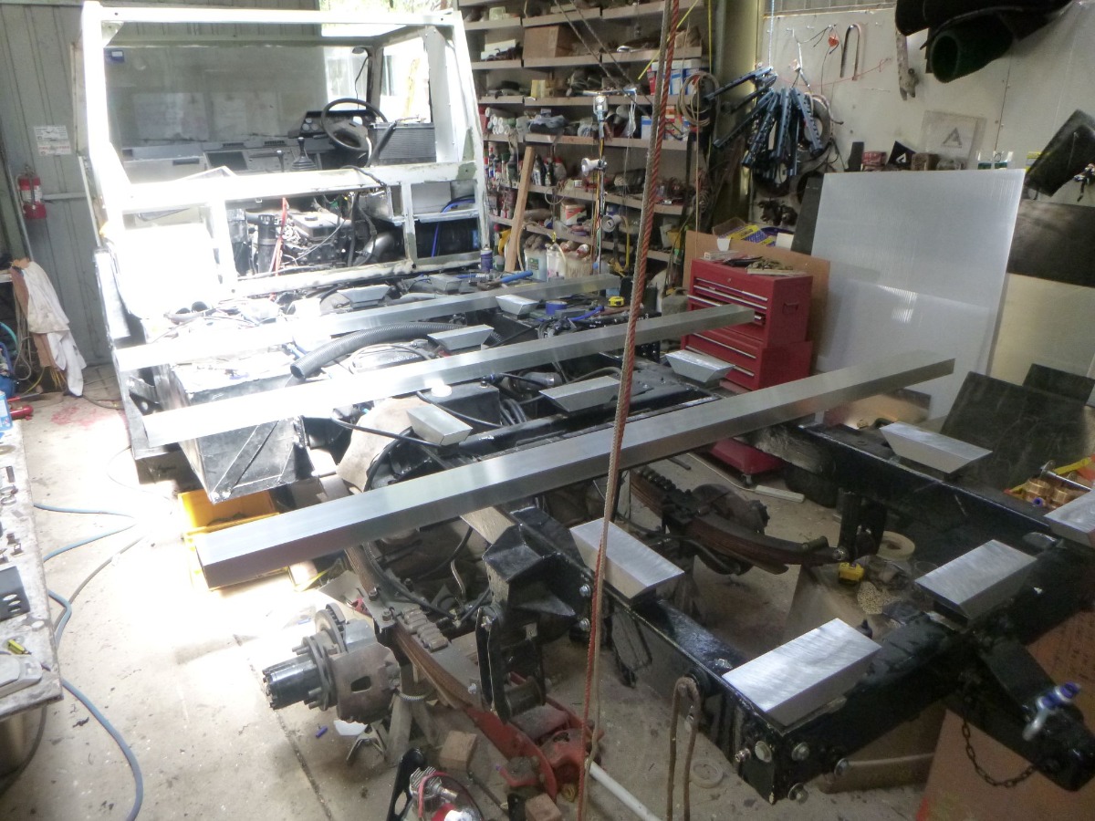

With #196, the box (with frame) was on a steel sub frame. That was mounted to the chassis using standard OKA body mounts (12 from memory). I did shift the back 2 from the bus position over the cross member to the chassis rails.

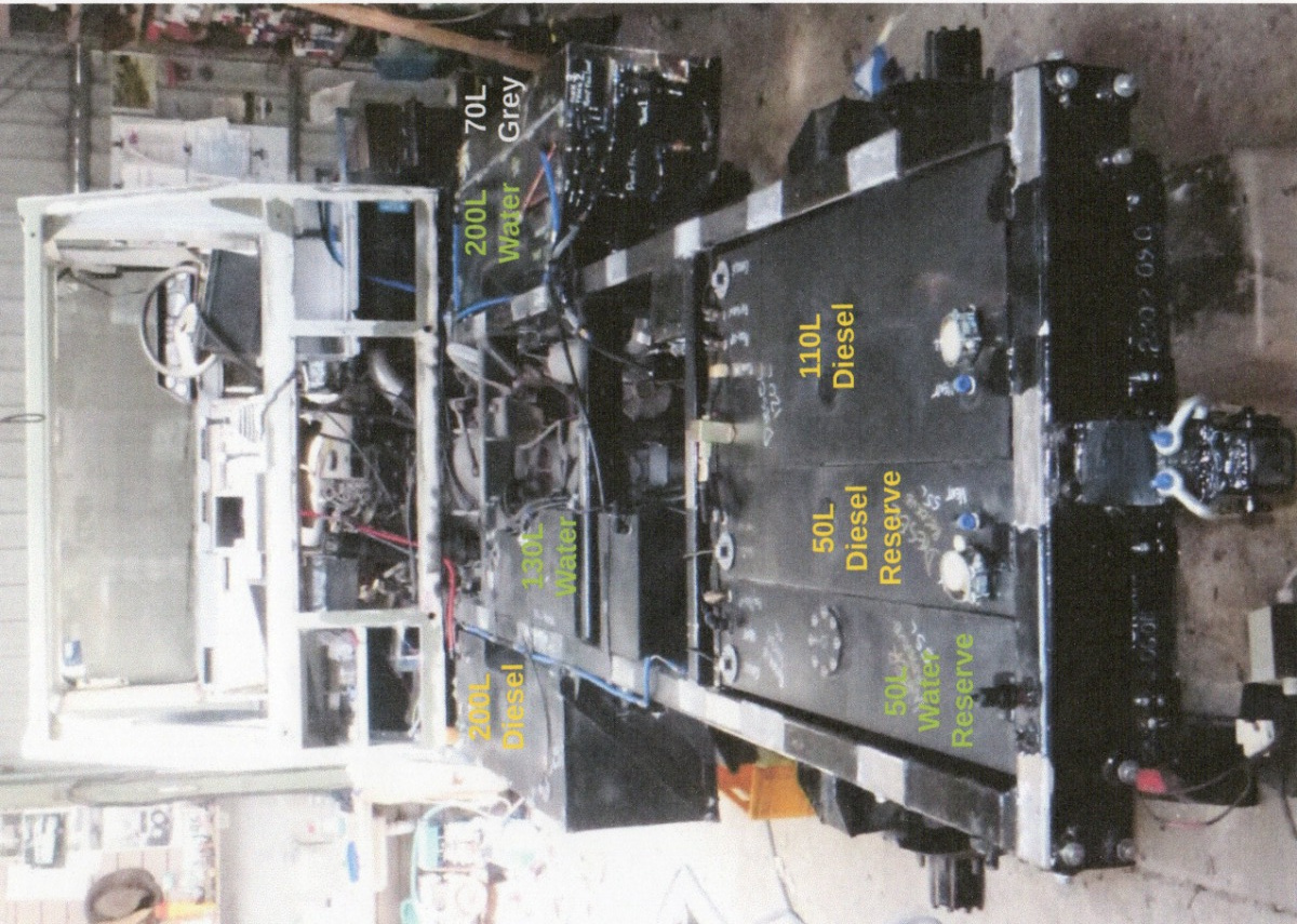

With #077, I have been much more radical (with my engineer's support).
Tanks and most plumbing and some wiring in first. It is accessible later, but easier before the floor goes in.
I moved the rear cross member back about 300mm. This gets it closer to the rear wall of the box for better support and to give better space for rear tanks and to make the tow bar short and light (rated to 3.5T).
The rear cross member also becomes a compressed air receiver (only approved to 80psi because of the shape).
The white spots (pic above) on the chassis are raw metal where the 25mm thick polyurethane support blocks are glued.
On top of the polyurethane blocks are glued some aluminium tube cross members and short supports.
By attaching the floor to the chassis as I have, there is a huge weight of bits of steel that I have removed from the chassis, in addition to the substantial savings in the sub frame.
The floor is glued to the top of all those bits of aluminium.
The floor is the same thickness as the other panels but uses a foamed PET core instead of closed cell polyurethane. It is a tad heavier, but has better compression strength and is less likely to crush under foot.

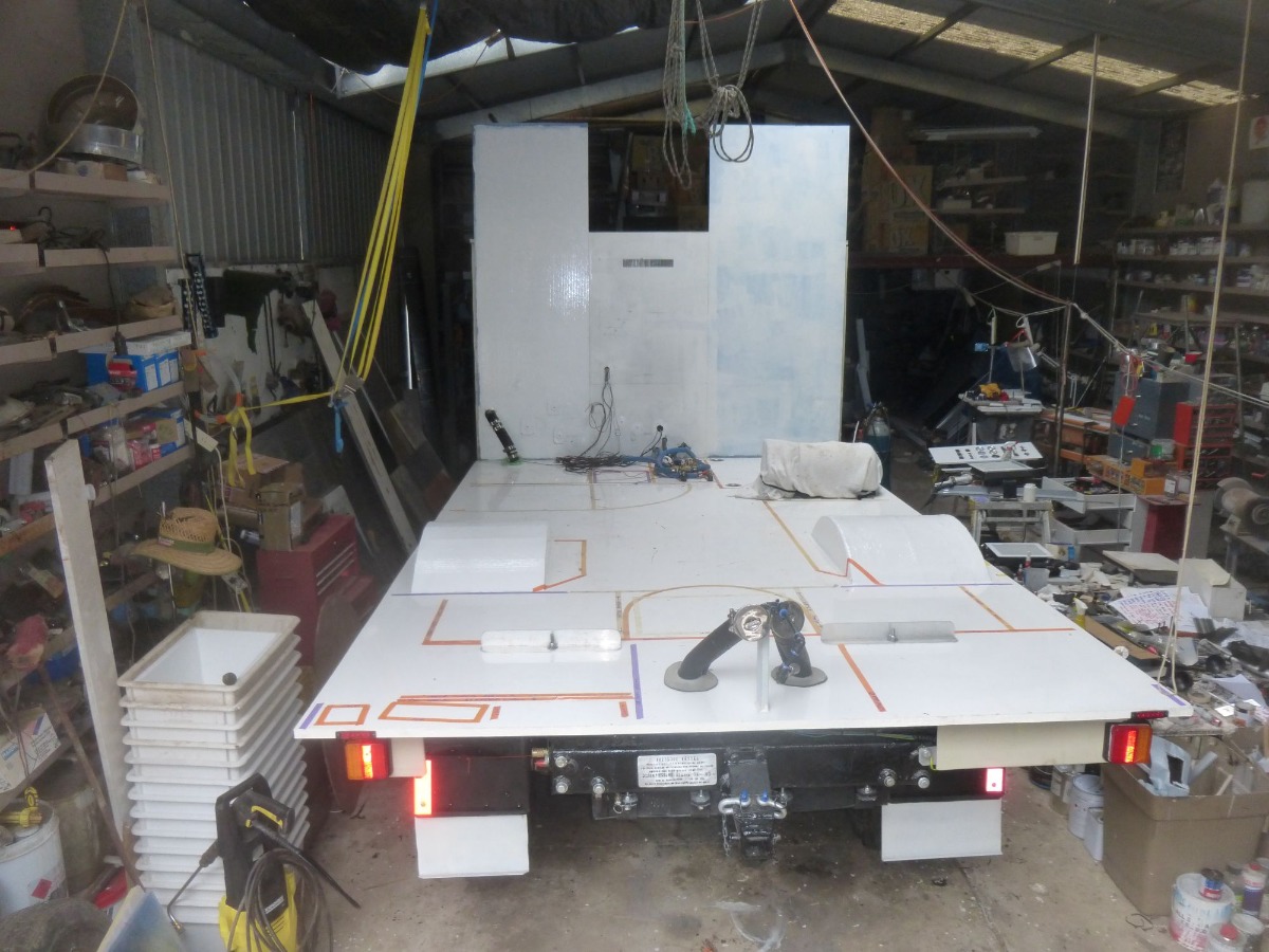

As pictured above, the whole rig still weighs a tad less than 3T (including the 4 off 323/85R16 wheels and tyres).
More later......

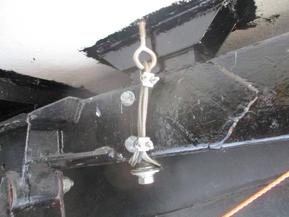

25 Jan 2026 11:52 #9 by Peter_n_Margaret
Peter_n_Margaret replied the topic: Does anyone have the original camper body and pop-top dimensions/drawings?
Couple of bits of useful detail.

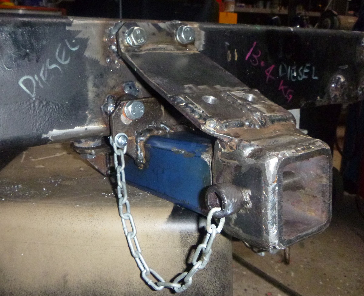

The glue used to attach the polyurethane blocks to the chassis and the aluminium was Plexus MA310 2 pack. Expensive & spectacular.
I expected to have some issues with doing this with the engineer. As it turned out he was not concerned at all. The important part for him was that if it failed, the box would not fall off onto the road.
That was easily accomplished with a couple of "safety straps" at the rear.
This also shows the polyurethane blocks on the chassis.
2 safeties, each attached to a piece of aluminium angle above the floor, inside a storage box.

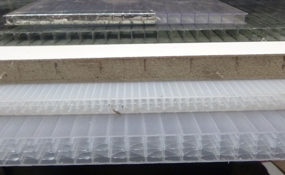

#077 is using very different material for furniture.
From the top down....

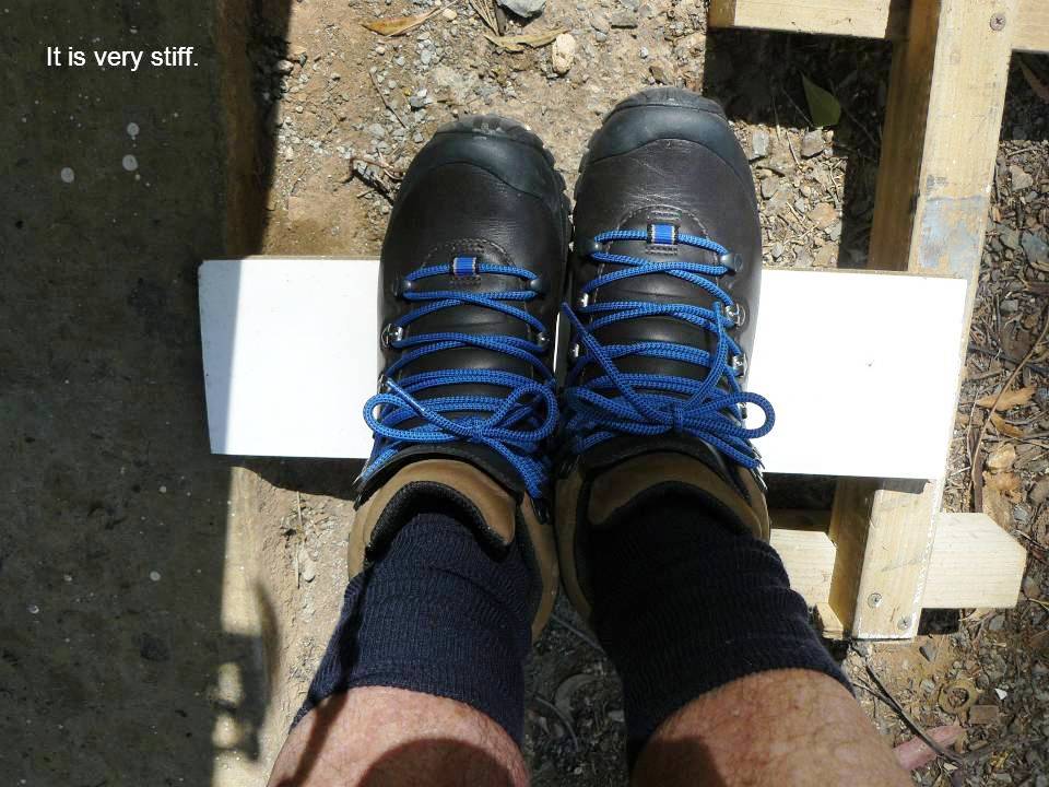

Top 2,. 10mm double wall polycarbonate roofing. 1.7kg/m2.
#3 23mm Vanglas sandwich panel, 20mm closed cell polyurethane foam and 1.5mm FRP skins. No gel coat on 'back' 6.1kg/m2
( Floor as above but with PET foam, 6.9kg/m2, Roof will be as above with 34mm foam for improved insulation under the solar panels)
#4 10mm multi-walled polycarbonate roofing. 2.6kg/m2.
#5 18mm multi walled polycarbonate roofing, 3.11kg/m2.
Most of the furniture will be the 10mm double wall material @ 1.7kg/m2.

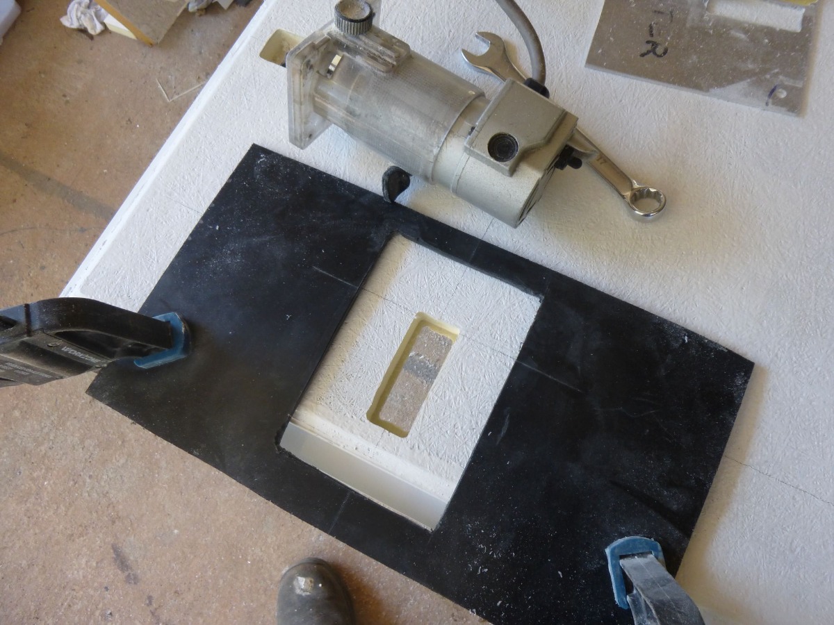

I have developed a few tricks for bending, painting and gluing this stuff and it will good for 90% of the interior.
All glued joints are easily reinforced with a light weight plastic angle piece where required.
The big vertical panels at the back of the cab in an earlier pic are the 18mm PC with an FRP skin glued to the outer faces that are external.
This is quite expensive stuff, but I found an Israeli manufacturer with a warehouse in Adelaide and I have almost enough in reject and off-cuts to finish the fit-out for the price of a few slabs of fancy beer.

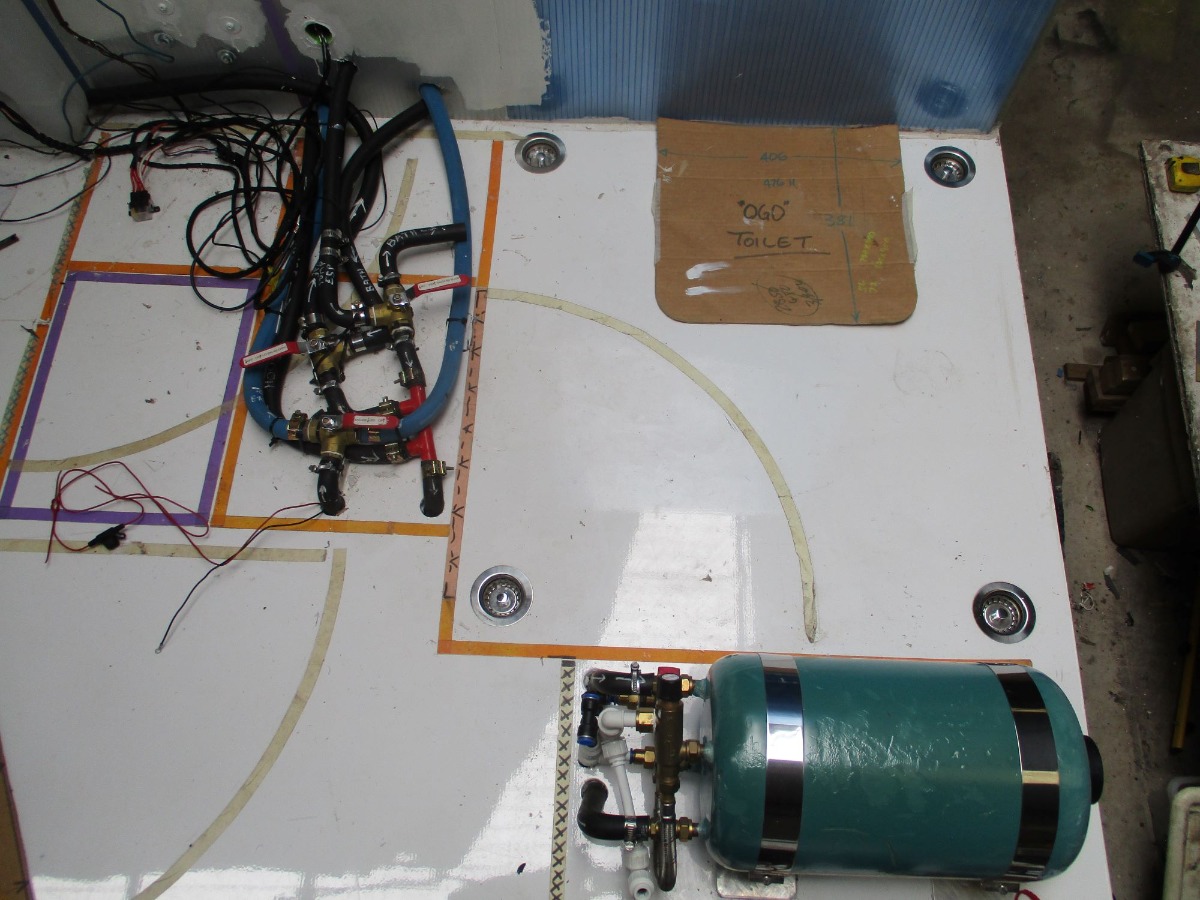

OGO composting toilet (see cardboard cut out on shower floor of earlier pic).
Diesel heater Eberspacher D5E HS3. Hydronic, expensive, brilliant.
We have had a Webasto version in #196 for some years. It circulates hot glycol to the HWS calorifier (heat exchanger) and to 2 glycol to air radiator/blower units, one for the bathroom and one for the living area. The one for #077 will be similar.
They are also connected to the engine, so drive 30 minutes and the HWS is hot, or run the diesel heater on a cold morning and pre-heat the engine. They can also be heated with 220V and 1000W from the solar/inverter.
The diesel heater itself is tucked into the back LHS of the engine compartment. There is a fair bit of plumbing to hook it all together, but the result is a completely versatile and brilliant product. You can see some of it again in that toilet/shower pic earlier.
The calorifier is that tank in the foreground of the same pic. In #196 I used a 30L calorifier. Due to weight reduction and heating speed (which is fast), I fitted #077 with a 10L calorifier. It is right next to the shower and immediately underneath the kitchen sink. No wasted hot water. I am sure that it will supply hot water at a rate sufficient to provide (almost?) continuous showers if required.
When driving, the hot glycol can be circulated via the radiator to the bathroom, with the bathroom door closed and with a sliding window in the bathroom slightly open, we can heat the bathroom without heating the rest of the interior and we have a very effective cloths drying room, all using waste heat from the engine.

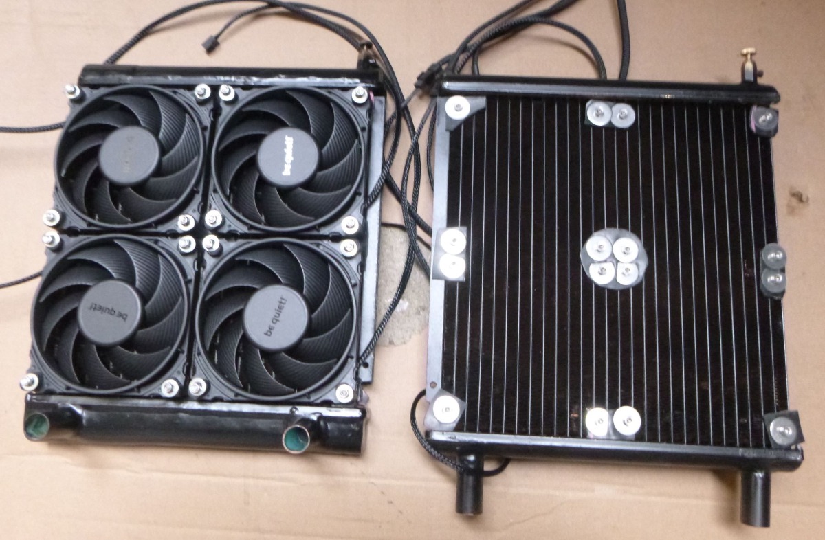

These are the DIY heat exchanger/blowers. I did not like any of the commercial ones because they were all too noisy. #196 has similar except no PWM speed control and slower fans.
Custom made single core radiators, very quiet 120mm high speed fans with PWM speed control.

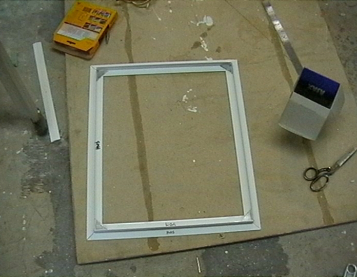

25 Jan 2026 14:57 #13 by Peter_n_Margaret

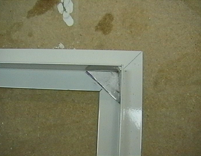

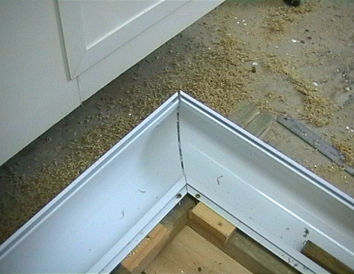

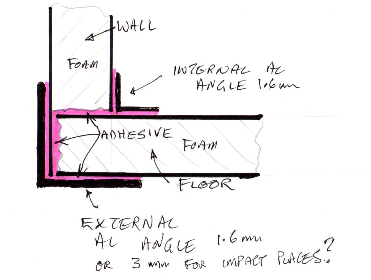

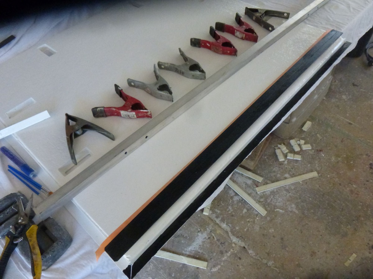

walls and roof. Could you please briefly talk about how that goes together without a frame?[/i
This is what I will do on #077.
Should be self explanatory?

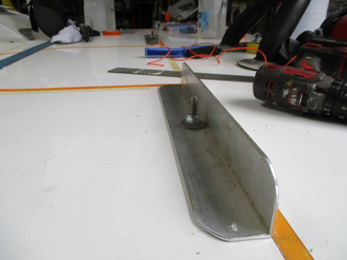

Getting glue strength is about good quality prep, good adhesion and high surface area.
There are still traps.

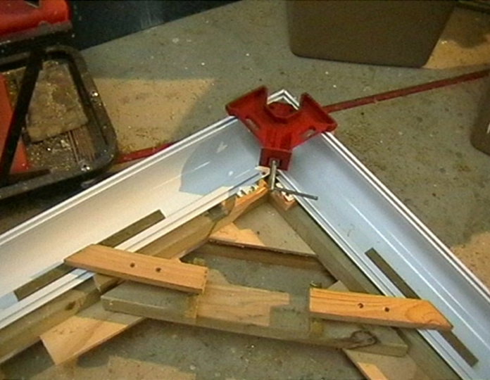

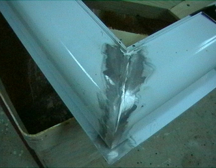

There is a differential expansion between the sandwich panel and the extrusion. You need to know what that is and what elongation-before break that your selected glue can accommodate. Having the glue joint too thin for its elongation capability will cause it to tear and fail. The message is to make glue joints between dissimilar materials THICKER.
I had some on #196 that needed to be 4mm thick when using Sikaflex252 which is a higher tensile material. Lower tensile grades can often be thinner.
The inside extrusion can usually be in relatively short sections to overcome this problem.

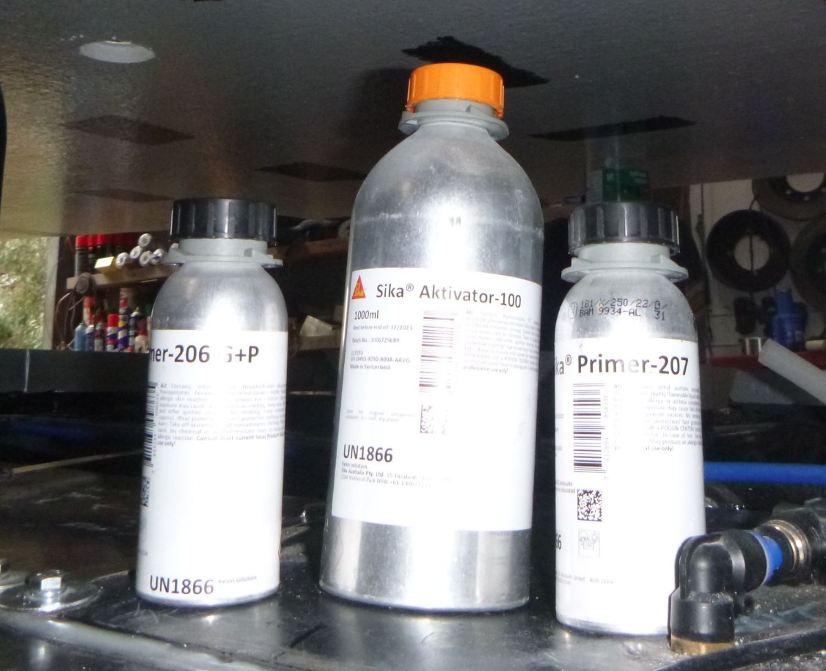

Sikaflex make the premium products, in my view, but they are also very expensive, compared to many others.
For #077, I am using Wurth Bond and Seal. I think it is adequate for the structural jobs, if you do them well. Buy it by the box. You will (need to) use more than you think. These materials also have relatively short shelf lives. Check the primers/promotors at point of purchase.
Follow Sikaflex instructions and use the Sikaflex primers and adhesion promoters, even if you use some other brand of single pack polyurethane adhesive. Different surface materials need different treatments.
For internal furniture joins I use a 20x20 thin PVC 90 degree angle extrusion.

ps..... to ensure that a glue joint is the appropriate thickness, put a spacer between the 2 bits in question.
Often, I will use small patches of double sided self adhesive foam tape folded to be the target thickness.
Appl LOTS of adhesive, press the parts together over the tape and the tape will help to hold the parts in the right place as it goes off.
pps... The join between the main panels that I suggest above avoids any "cold connections" where a metal component that is outside can cause serious condensation if it is also inside.

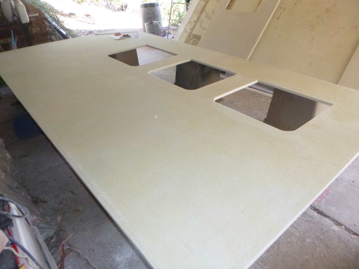

- pro's and cons of using some sort of aluminium framing for this style of build?
Not needed, unnecessary expense, will cause additional differential expansion issues.
This is slightly thinner panel used on #196.
Last Edit: 25 Jan 2026 15:18 by Peter_n_Margaret.

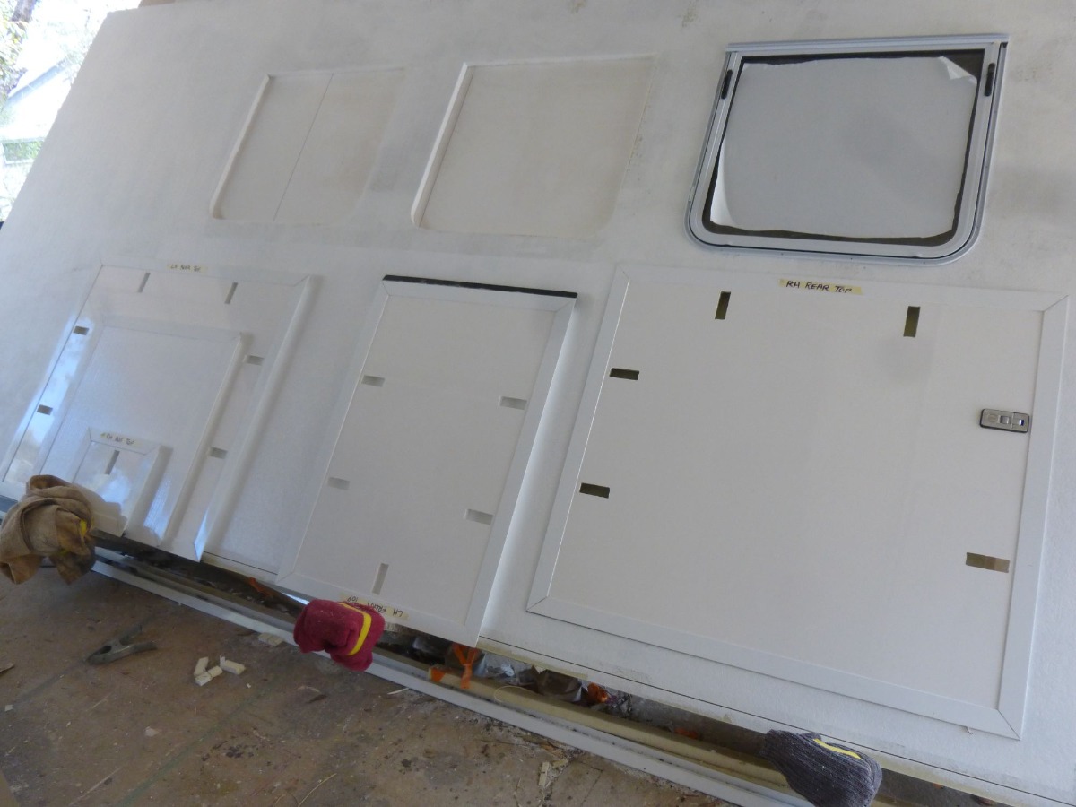

It needs to be emphasised that these posts from me represent what I have done and are am doing and that there are many options to achieve the end result. If you look at every OKA camper, there are no two the same, so clearly most other people do it differently from me.

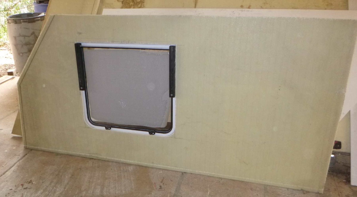

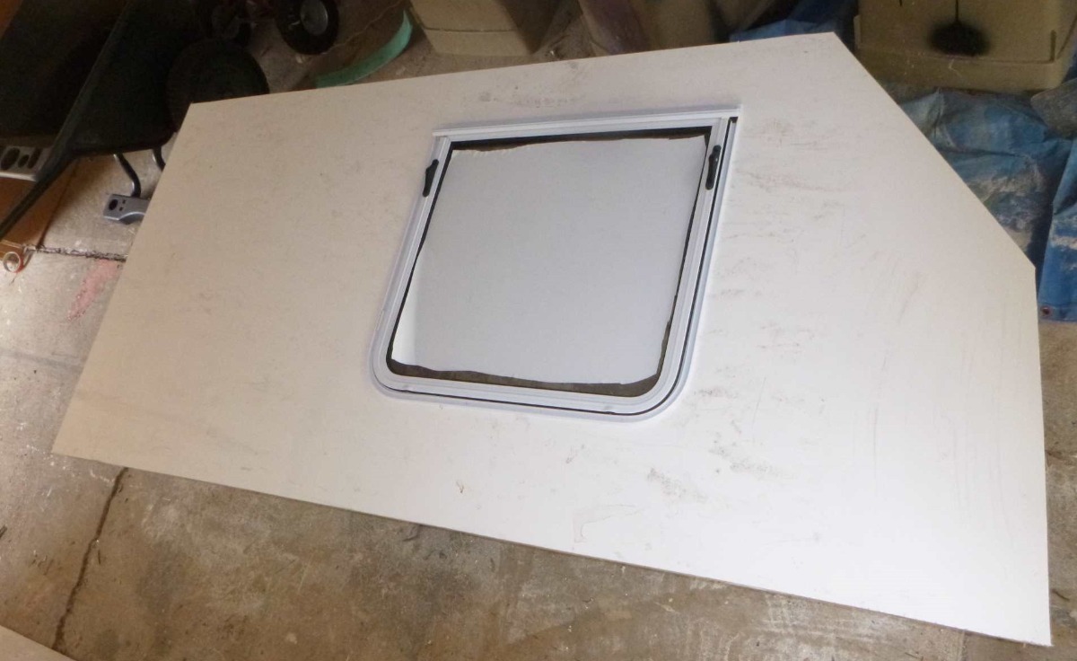

Did you make any specific frames for the door or any windows/openings, or are the panels inherantly strong enough?
The panels are inherently strong enough.
20 years ago, I used the old Australite wind out windows in #196. I used to bust about 1 or 2 per year on trees until I reglazed them all with 3mm polycarbonate. No more breakages. Then a few years ago the vehicle rolled down a hill with no one on board and a couple got destroyed and replacements were not available any more, so I replaced the lot wit some locally made sliding windows. I don't like them.
With #077, I discovered that there is now a Chinese copy of the old Australite window available. There are some minor differences, but generally they are the same sizes and I have bought them. I have reglazed them all in 3mm scratch resistant polycarbonate, replacing the "bubble" acrylic.
Fitting them to the wall is a matter of cutting a hole, gluing them in, a little bog on the inside to make it clean and it is done.
Side wall with 3 window cut-outs/
Outside of bed-over wall with window fitted.
Inside of bed-over with window fitted (not glued-in yet, I won't do that until the walls are fitted).

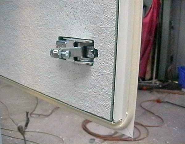

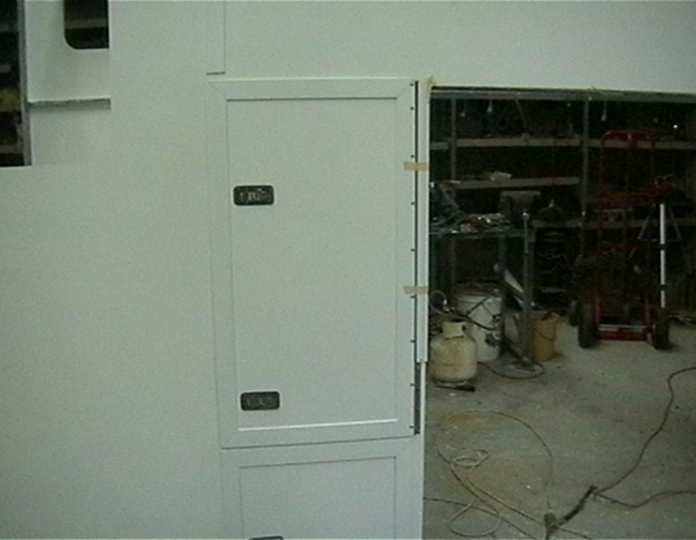

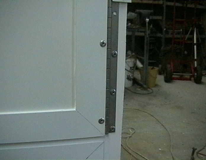

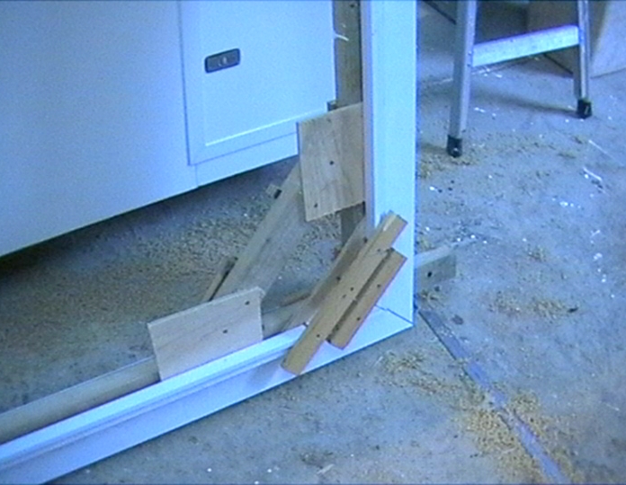

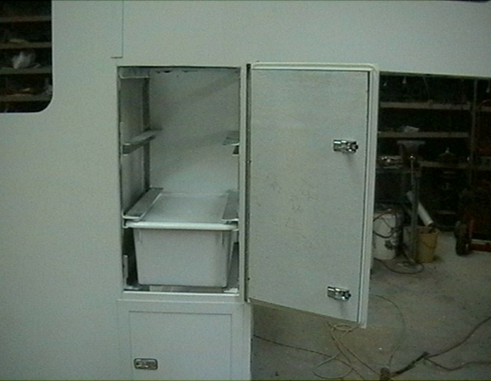

I plan to make my own door for #077. Commercial doors are pretty crappy and quite expensive. It will be similar to a storage hatch.

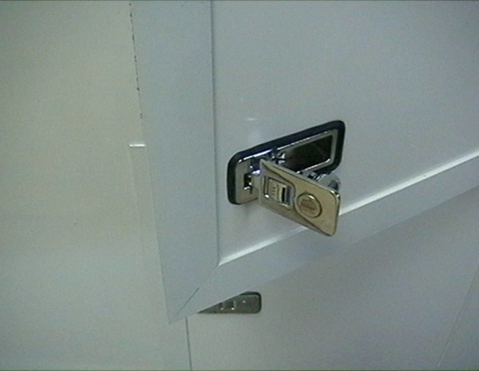

With #196, I wanted to buy external hatches, but could not find the sizes I wanted and again, what was available was expensive, so I made my own and they have been quite simple to make, highly durable and cheap because they come from a hole cut out of a wall.
These are the basic steps....Pics are from 20 years ago.
1. Make a picture frame from 20x20x20mm powder coated aluminium "T" extrusion.
2. Reinforce the corners wit glued-in bits to hold it together while fitting the panel.
3. Cut out the holes for the latches and fit them and add a self adhesive seal.
(3a. I did make a couple of router templates to cut the holes for the latches)
4. Add a piano hinge and attach to the wall.
5. Bog up the gap inside between the panel and the frame and paint the inside.
Not much has changed in the method since then.
The most significant change for #077 is the hinges. I am using a carbon/kevlar piano hinge which is glued-on instead of the riveted S/S piano hinge. This is much quicker, lighter and it is dust and water proof. And it is much thinner which means it is closed when the hatch is closed so the exposed side does not need to be covered. Much neater.
Last Edit: 26 Jan 2026 05:56 by Peter_n_Margaret.

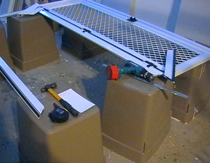

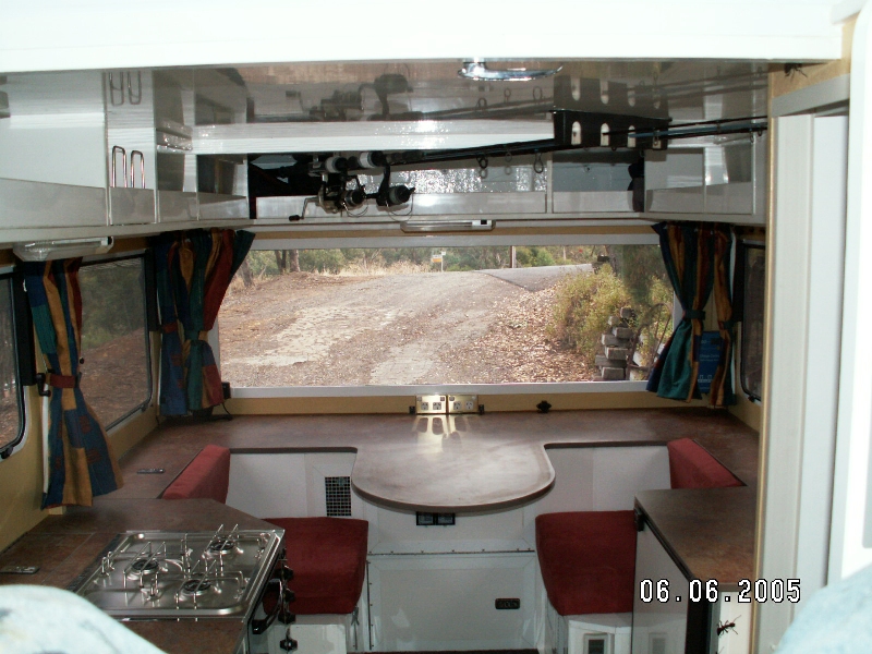

I am looking at various options for a pop top (aware that it invites potential cost/complexity/problems). How might you see one working with this sort of construction approach?
Not sure I can be much help here.

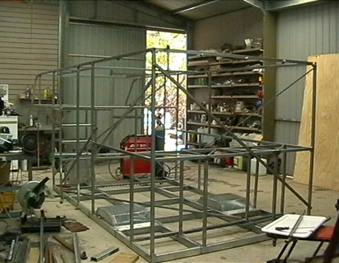

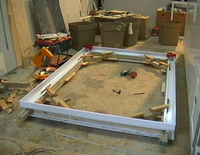

With #196, I used commercial pop-top aluminium extrusions. 6M lengths. Still have some left-over bits.
I would never do that again. Terrible "cold connection" condensation inside, and expensive.
If I did it again, I would fabricate the whole thing using left-over strips of sandwich panel for the edges instead of the extrusions.
This is what I did.....
I had someone else weld the corners for me as my aluminium welding of thin material would be very sus. It is supported by 2 gas struts which work extremely well. easy to put up and down and lockable at a single point, all from the inside.
Cons:
Expensive vinyl section (with long zips and fly screens) needs replacing at about 12-15 years.
Noisy at night when the wind blows and the sides flap, despite being kept relatively tight by the gas struts.
Gas struts last 5-10 years.
Inside lock has been a water leak issue (currently fixed).
Insulation via the vinyl section is about zero (but not a problem in the cold with a good diesel heater).
Pros:
The hinged nature of the pop top means it is actually possible to stand on the bed at the rear (head) end.
The 3 very large hinged sections provide excellent ventilation.
And totally unexpected - The height and large ventilation area creates a thermal chimney that draws air in through the windows and out through the pop-top.
#077 will have a fixed roof section that is about 250mm higher than #196 and no pop top.
Everything is a compromise.
A full length pop-top will mean a lower vehicle but you will also loose the overhead storage facility.
This has been a winner in #196.
#077 will get a lighter weight version. This is a prototype.
ps... the pop-top roof is strong enough to be an event viewing area.
We have had 6 people up there at any one time and no problems at all. :)
