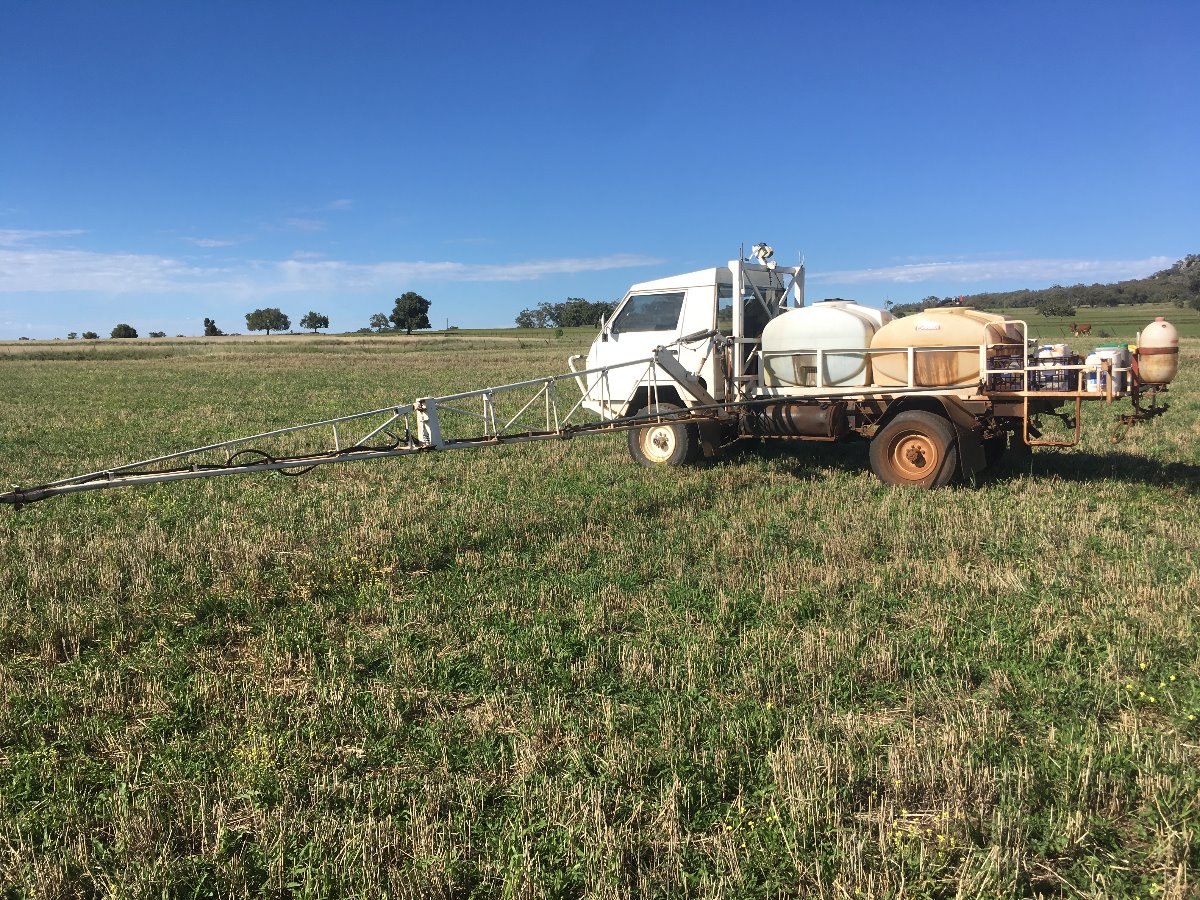

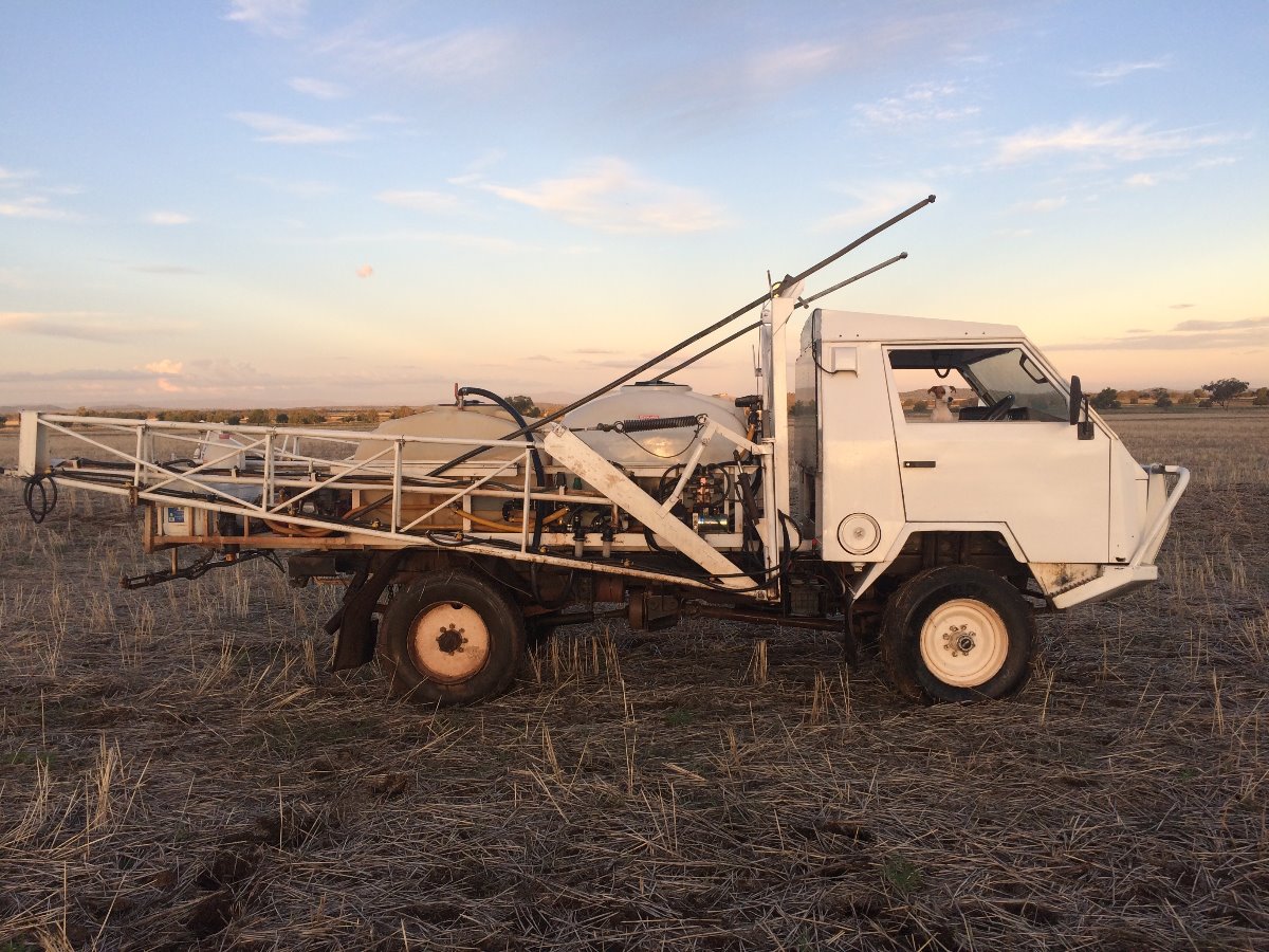

Thought I'd add some feedback to my continuing experiences using an OKA as a spray rig.
We are coming up 18 months/2 years of spraying using the rebirthed OKA350 and our overall impressions are quite positive.
For anyone looking for a sprayer platform that carries more water than a landcruiser, and uses less fuel than a landcruiser, the humble OKA is worth a look. We usually only work in first gear, at about 15-16kph and carry 2200 litres of water and we do that reasonably easily despite some steeper hills. Maybe the thought of spending a whole week in first gear apart from a few paddock commutes is a foreign concept for some, but thus far we have been happy with it. The neighbours even borrowed it and gave it the thumbs up.
Ivé found a few improved photos of the setup if anyone is interested. Our restoration of the vehicle was entirely functional so some things may look a little basic. We may decide to add door linings and decals later if we get extravagant. IMG_0015.JPG[/attachment]
regards Mal
