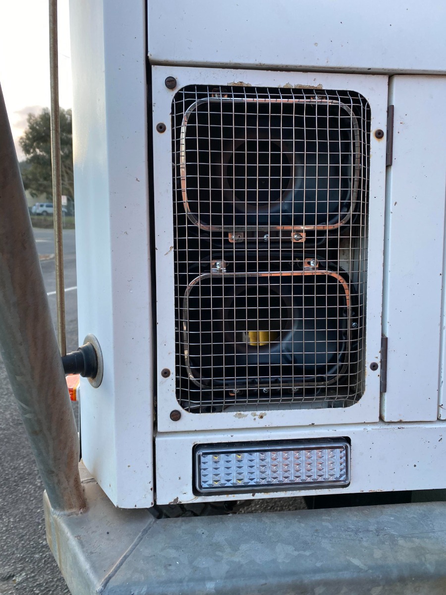

So far I have fabricated new double 7x5" headlight buckets that fit in the original headlight bracket, replacing the decaying stock 7x5" bucket and whatever it was the halogen flood would dangle from. Lots of little mods and quality-of-life upgrades waiting to go in, but first, go from front-wheel drive to four-wheel drive again! Reversing and low mount front trail camera for navigating features without a spotter, planning to upgrade to LT dash on XT and fit a Garmin RV Vieo head unit that does all the normal audio/gps functions, but can control electronics - if that's possible with the 12/24/48v house setup I have rattling around my head. Generally replacing all factory-era components with bits that have modern part numbers - a simple and easy task really, for the well-intentioned and in some ways poorly executed parts bin special that we all know and love. Wipers, indicators, bulbs, housings, antennas, motors, blah blah blah. Eventually hose work and wiring, bits and bobs. The un-initiated to the love-hate affair that is OKA (or equivalent) ownership might say 159 (or equivalent) is a lemon. I strongly rebuke those comments, it's a 30-year-old 1-of-maybe-300-still-operating wonder bus. The work we put in now guarantees another 30 years of service with irresistible OKA charm.

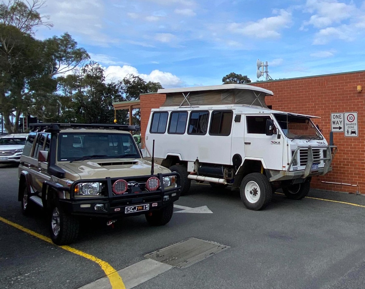

Compared 159 to a buddy's BRAND NEW 76 series cruiser. I know which one I prefer.

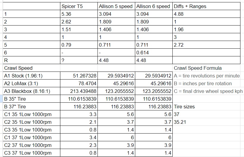

Not that I don't trust my NP205, but based on the following chart I threw together:
As you can see, 1.96:1 gives an acceptable crawl ratio of 51:1 with the Spicer, but an unacceptable 29:1 with the Allison 1st gear. Without getting political, the Spicer deserves respect but is past its supported service life so it's not an option long term - plus I already have an Allison with the 4BT.
If the LoMax goes in before the engine and transmission swap (still working engineering angles, plus finding a workshop in Hobart that can do the swap) then I will have 78:1 crawl with 3:1 low gear. This is getting better! The decision point comes at what angle to set the driveline for the NT spec 4BT. Having spoken to Dean, NT is set at 2 degrees and the XT is set at 7 degrees. Dana says 7 degrees is the "safe limit" for their axles at flat level ground, obviously a large safety margin for axle flex and the weather, etc. Online consensus is 30 degrees is the amount of driveline angle you can usually achieve before something goes bang, not accounting for running out of splines in your driveshaft slip yoke.
The jury is still out on the driveline angle, however, driveline length is at least 6" longer from the front of 4BT to Allison tail housing output, my new bits are still being crated up so I can't confirm this for myself but what I'm working off for now. I haven't gotten into minimum tail shaft length yet, but that is a factor to the following:

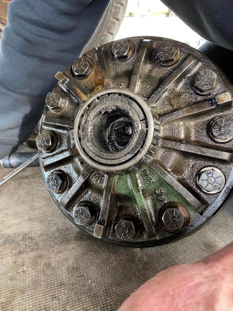

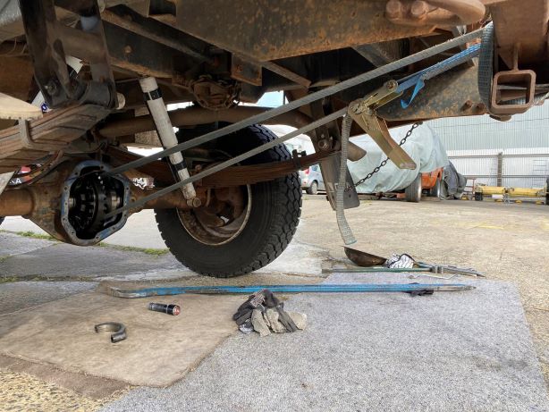

So today is the day we found out where the axle shaft decided to snap, and just how much fun 159's rear diff career was to remove!
As you can see, it was a simple operation involving a few light hand tools. Now that the LSD is out, we can turn our attention to why the carrier was binding and losing backlash in one spot, whether it was spun clockwise or counterclockwise. My man is pretty sure there is no damage to the pumpkin, though we haven't ruled out the tube bending after 30 years of mixed-use. There is no obvious reason for why the axle shaft failed, but onwards and upwards.
I would like to not have to buy a new 4.88 ring and pinion, but if that's what it takes then it is what it is. We'll see after a quick spin on a lathe, and inspection for wear due to diff glitter rolling around in the oil for the 300-400km of driving I had to do before I could pull the shafts and isolate the carrier.

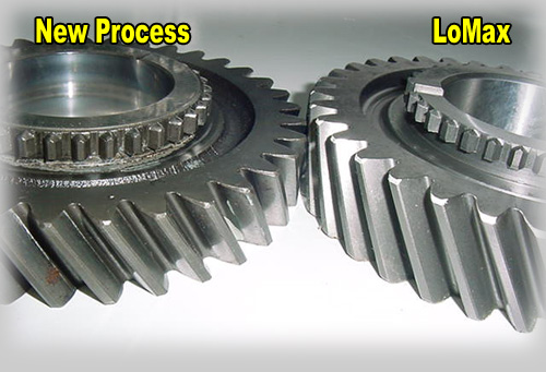

I put down an order for the JB Conversions 3:1 LoMax NP205. The NWF Blackbox would be amazing with the Perkins/Spicer/3:1 but more than a little overkill, so it can wait for the Cummins + Allison swap

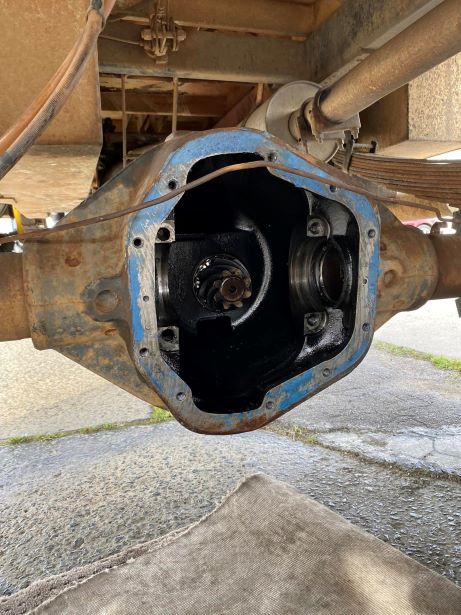

As part of the restoration of 159’s rear end, it turns out the carrier caps are spun, and had a questionable repair over 25 years ago. The 4.88 ring and pinion was smashed, so I’m taking this opportunity to regear to 4.56 for the 37s that are on the way, and the eventual 3.9L ISB170 and Allison 1000 5 speed conversion. That meant a bit of fancy machining and engineering to return crush to the caps, otherwise the Dana 70U would be in the bin. The questionable repair and resulting wear definitely helps to explain why it was so difficult to remove the carrier, and might lend itself to how the back end had a catastrophic failure - but it's beyond nailing down a single factor that caused the axle shaft to fail.
The carrier cap solution was easy enough, and now after 10 in-and-outs to fit and set the ARB airlocker, it has become clear the 25+ years of spinning carrier also damaged the inner face of the tubes.
So that's up to my man Neil and his engineering connections to clean up before the rear can be finally recommissioned. Interesting tidbit, ARB wants the carrier shims to go outboard of the bearings etc. The original LSD packed the shims inboard of the bearings, and not sure about other variations of diff centre. Neil is going to get the shim pack set, and then machine a single shim to avoid the shim pack all going kaput if the carrier needs to come out ever again/during operating.

In the new year, I will hopefully be swapping the original 1.96:1 NP205 for a 3:1 LoMax. That means I am getting a new spud shaft made up for the Spicer output to 32 spline LoMax input. If anyone has ever considered the 3:1 and Spicer combo, having a run of spud shafts manufactured makes everyone’s life easier and cheaper - so reach out if you’re interested!
