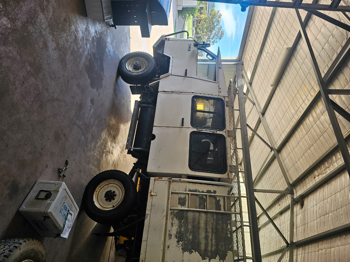

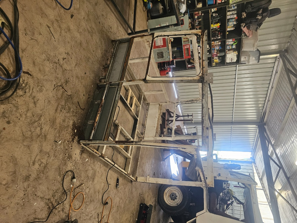

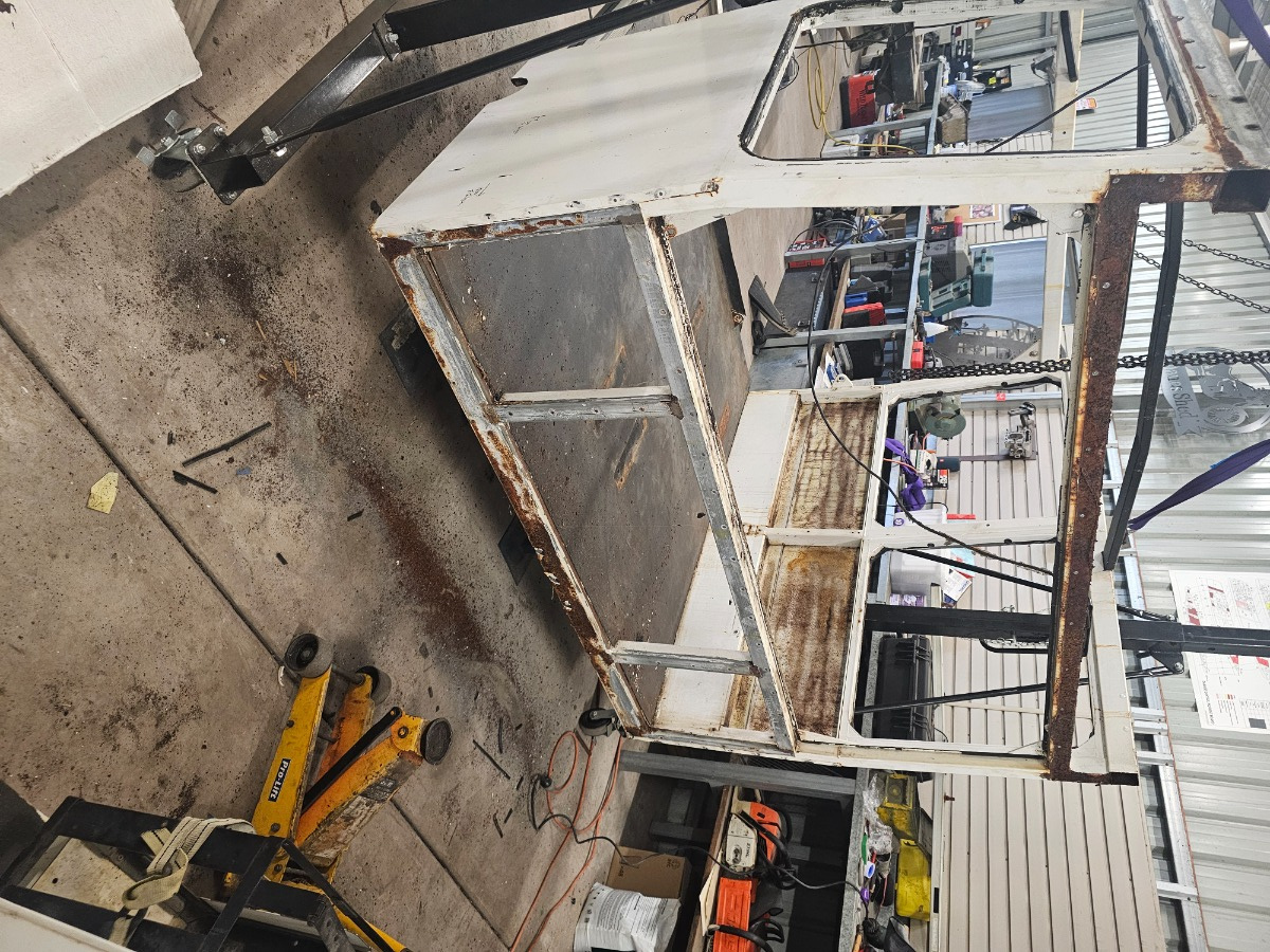

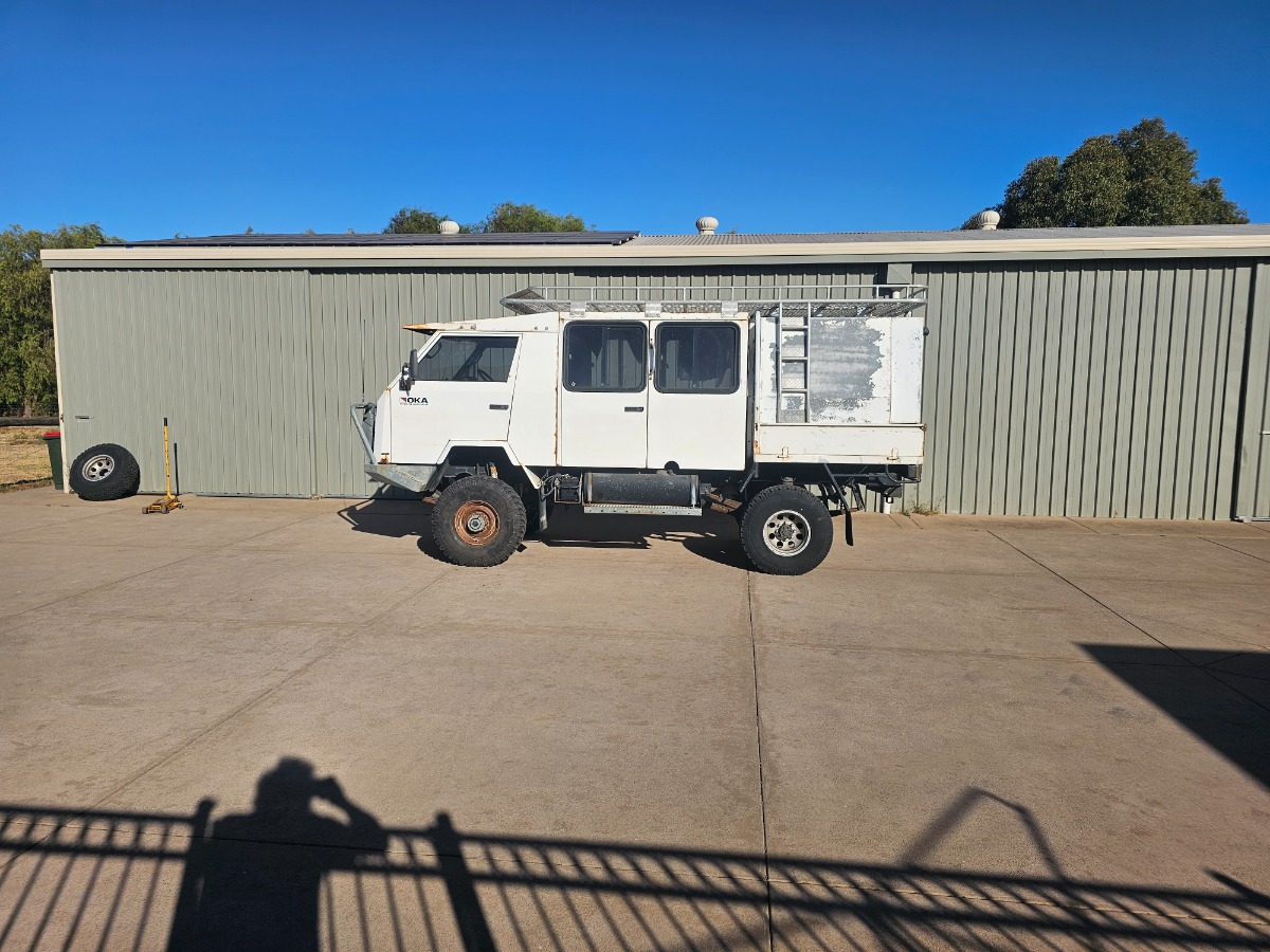

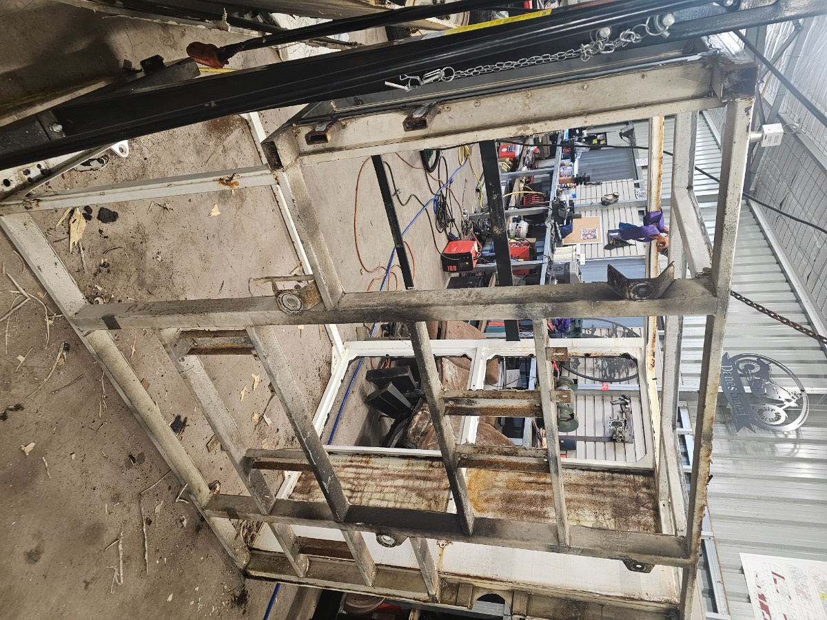

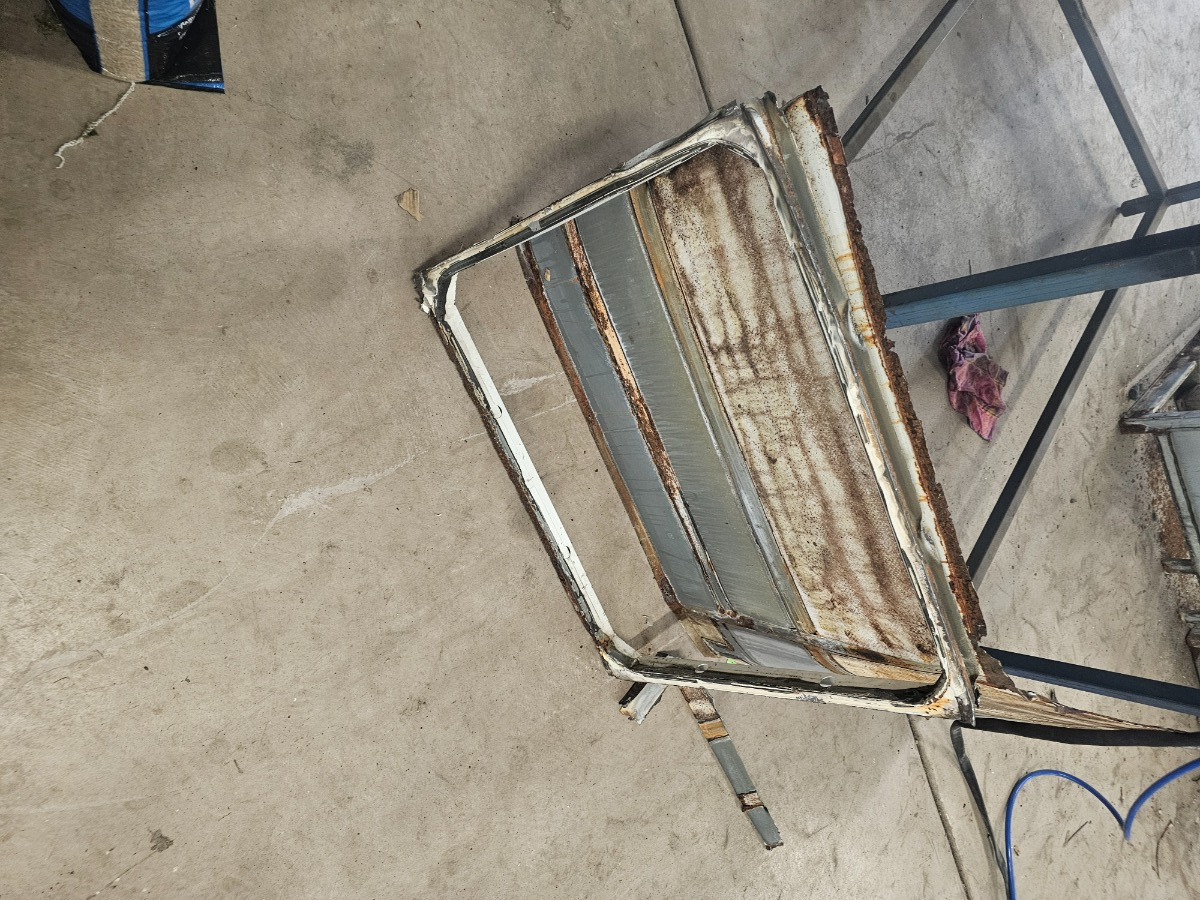

My plans are slowly progressing and the end goal is an extra size dual cab with canopy to travel with my young family in. I have posted a few bits and pieces on the Facebook pages but have decided to create a page here as well.

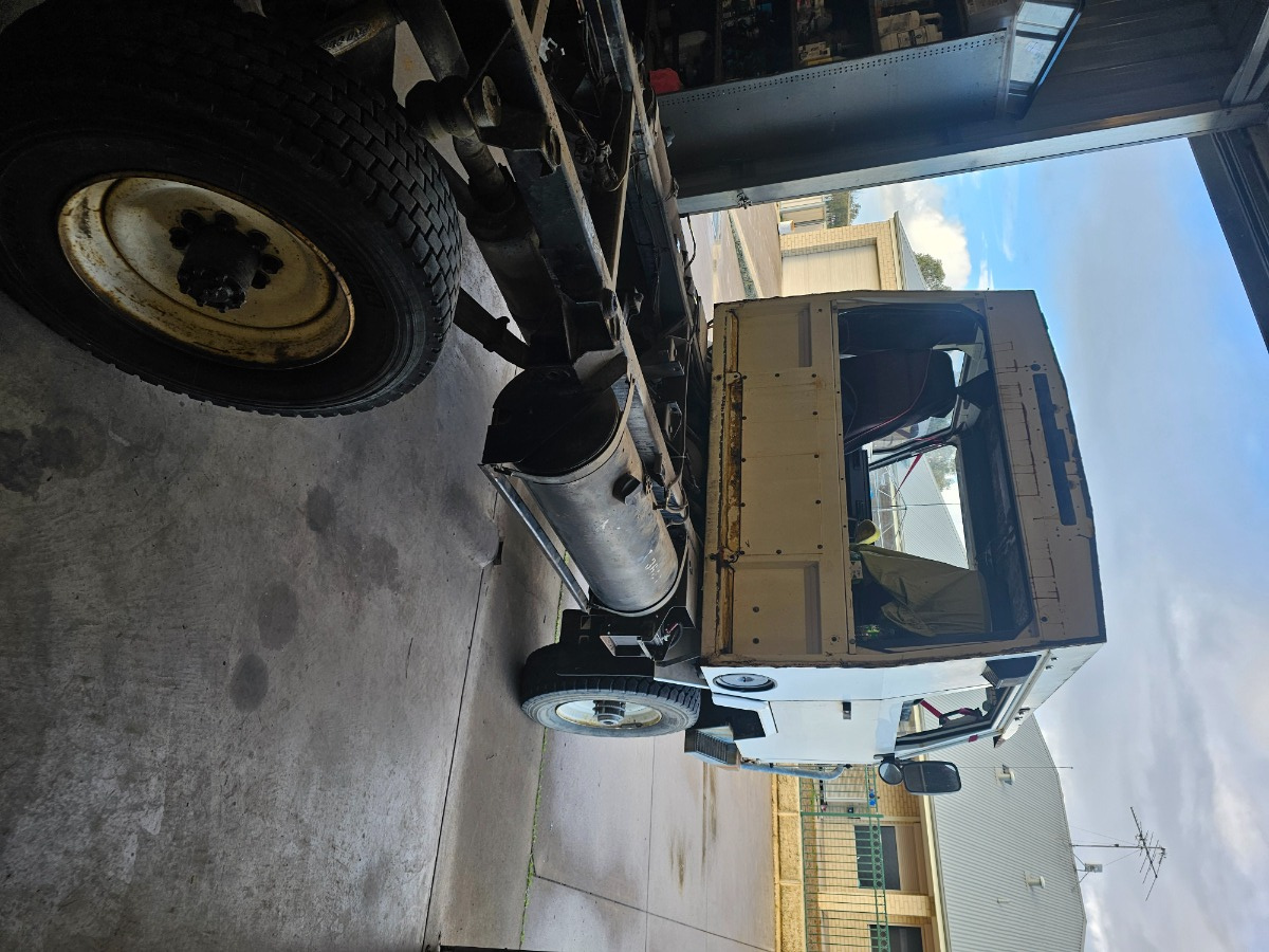

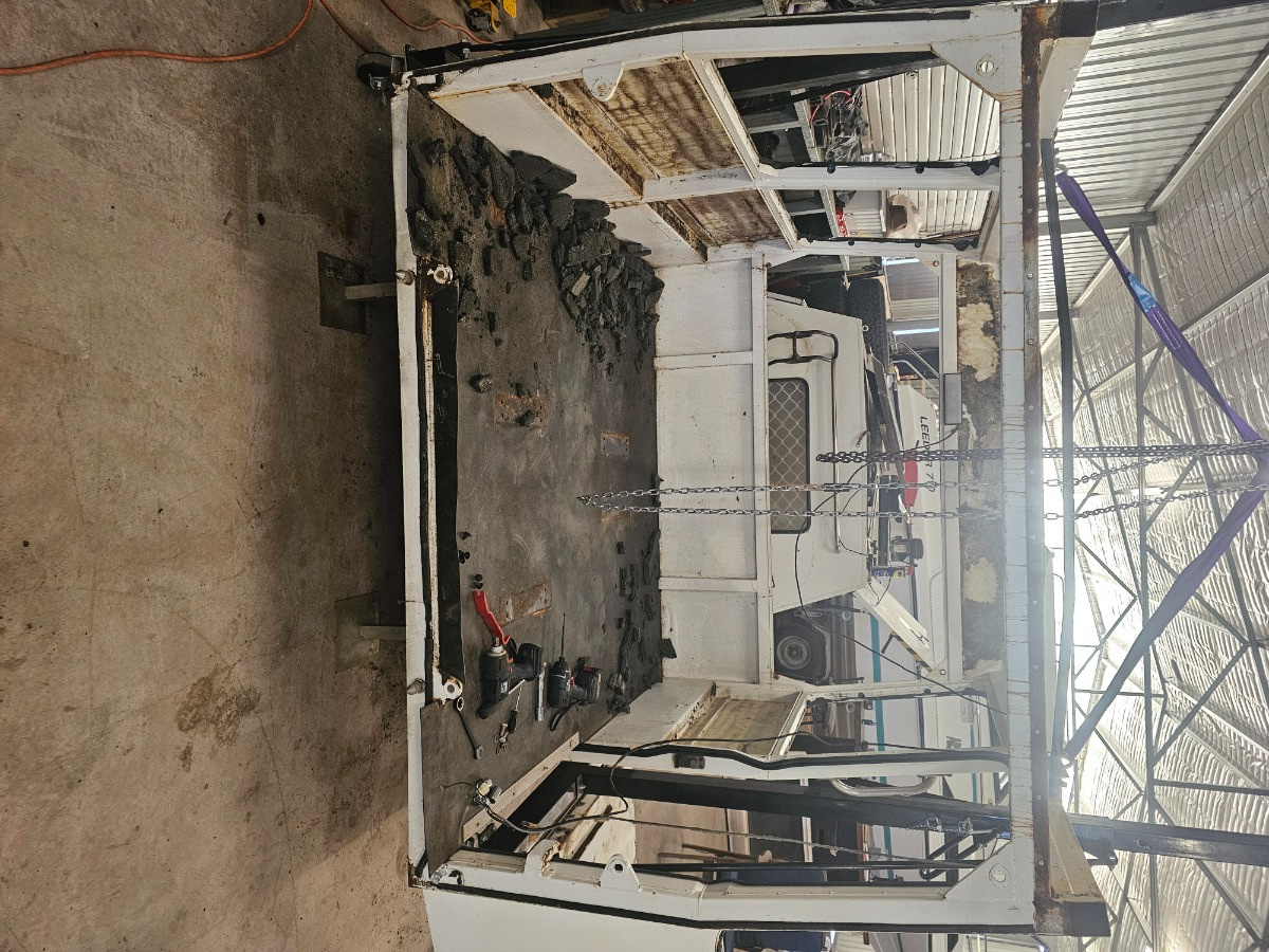

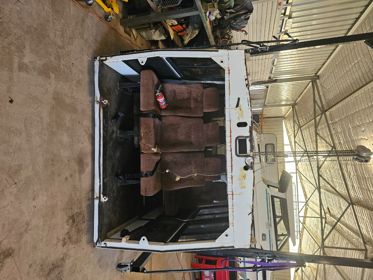

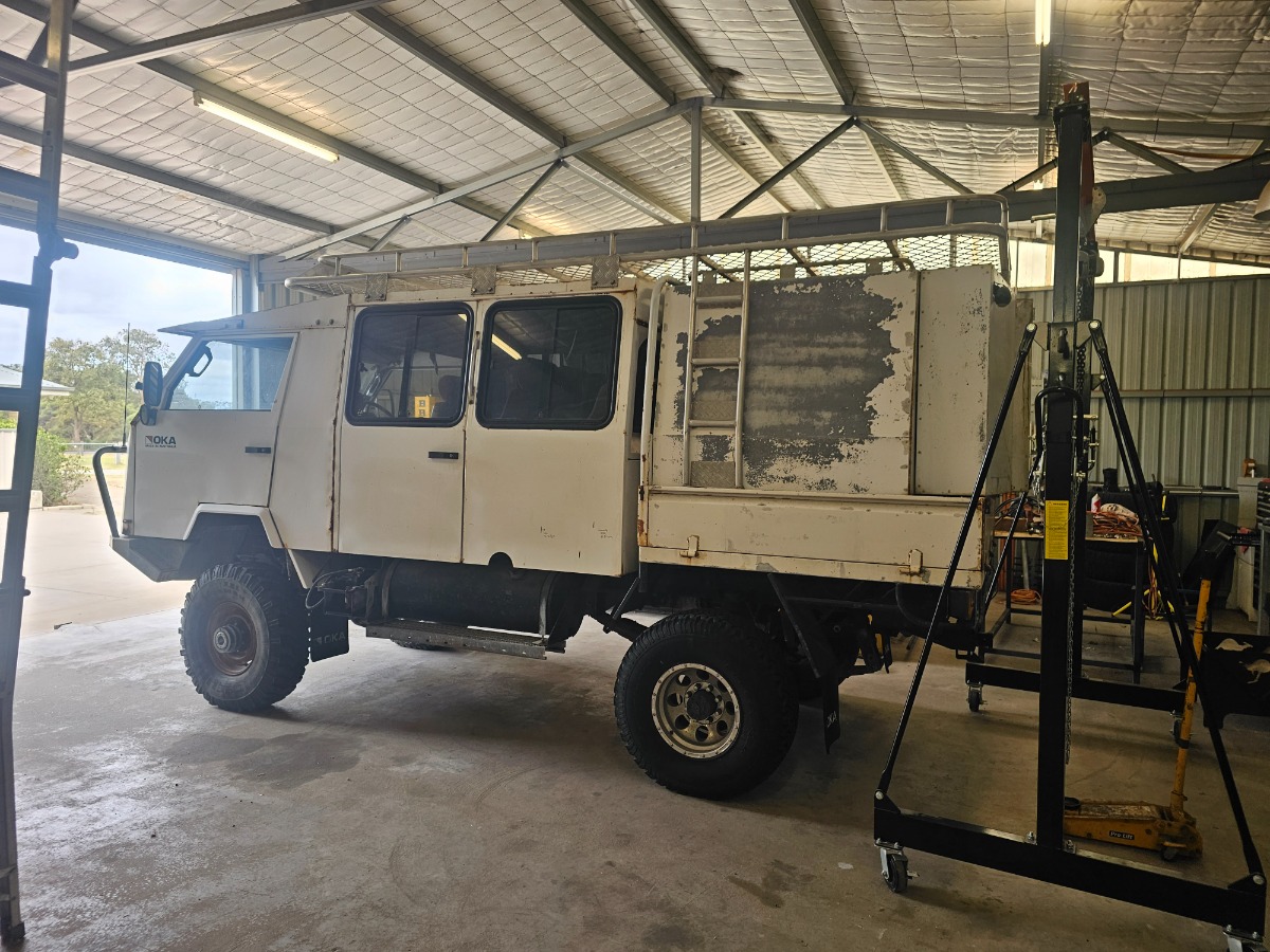

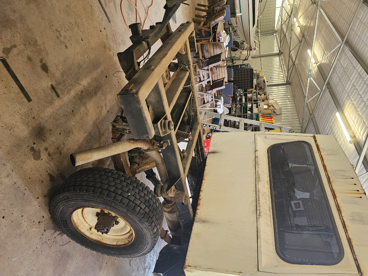

So far my rear module and the old tray and box have been removed with the multi module stripped and ready to cut down to the size I want. I recently got the room back in my shed to seriously start attacking the body work.
As I want to tow our van with this truck I am repowering and rebuilding this truck to have a GCM of at least 9t. The path I have chosen for my repower is a 210hp Perkins Phaser that is as I type this undergoing a rebuild.
Prior to removing the cab I'm getting all the 1% issues as sorted out as possible (gear shift etc) which will make the put back together phase a much better experience.
