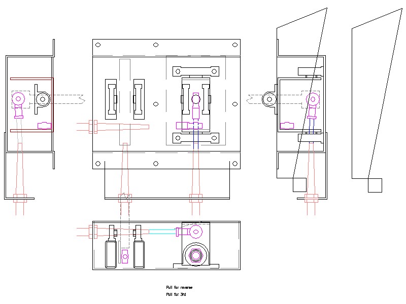

18 Nov 2024 09:13 #4
by Paul Scherek
Paul Scherek replied the topic: Oka 216 Perkins 6 Transfer Case Selector Issues.
No Dane, I made up a box that included the two levers. The transfer lever is at the left in the picture. It is quite simple - the lever pivots on a bolt between two bearings in housings that are sitting on posts. The lever is about 250mm above the pivot point, the cable attaches about 50mm below the pivot.

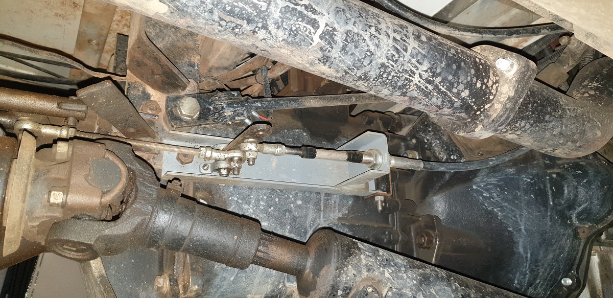

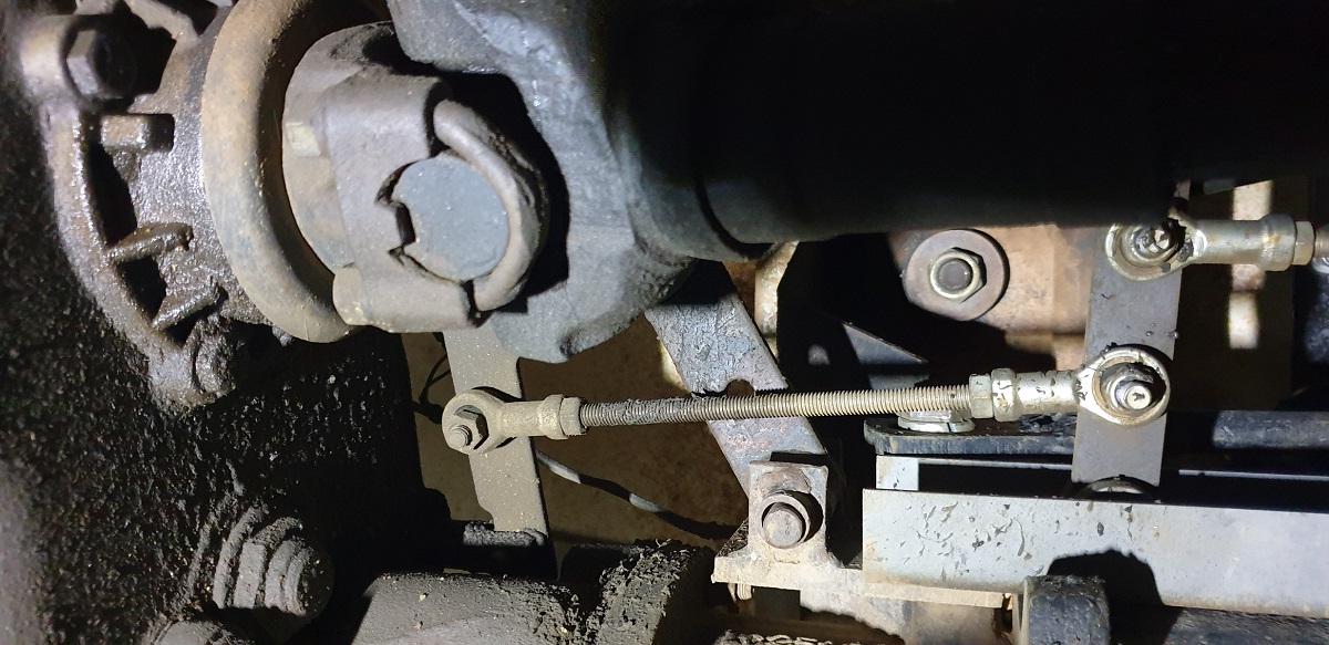

This is a pic from underneath
It is a bit difficult to explain ........ but is is simple, a lever mounted at the base on a 'pillow block' bearing with the lever used to reduce the cable travel down to the required transfer box travel. This is done to increase the cable travel thus reducing the load on the cable.
Pity we don't live closer... much easier to see it than describe it!

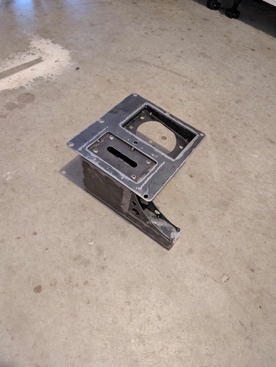

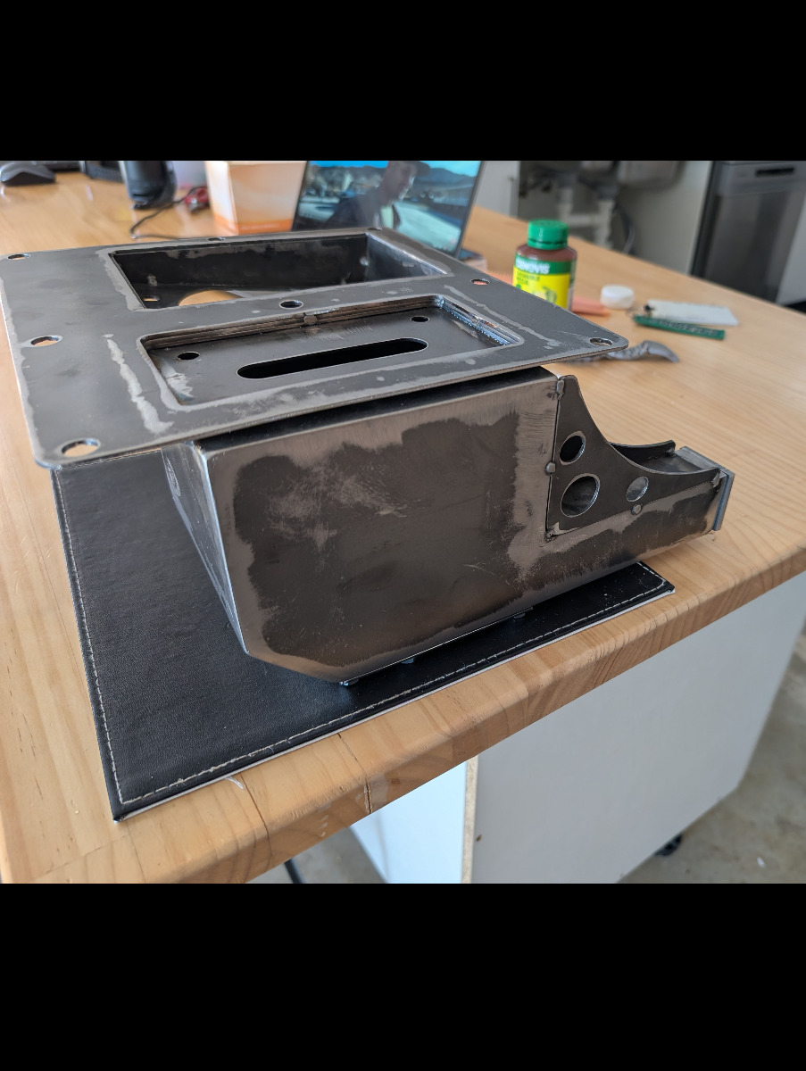

26 Dec 2024 06:08 #9
by Bart
Bart replied the topic: Oka 216 Perkins 6 Transfer Case Selector Issues.
G'day Paul, yes Bega is still a fair trot away. I recently visited my son in Perth and whilst there I went to see Frank Thomas who also has a cable shift. After seeing his set up we bought a shifter off him and set up a mock up to try. We then went down to see Dane with Oka162 south of Perth top test our mock up and after taking a few measurements my son made up a shift box using the shifter from frank which we heavily modified and also a redesigned shift plate to use the LT shift box on the XT. There's still a few wrinkles to iron out but we're happy that it will be a solution for the XT.
