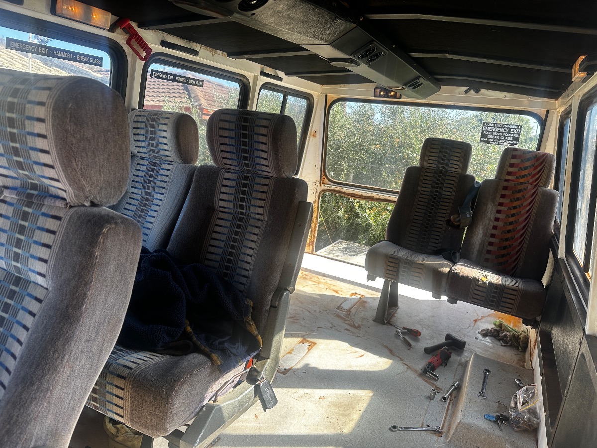

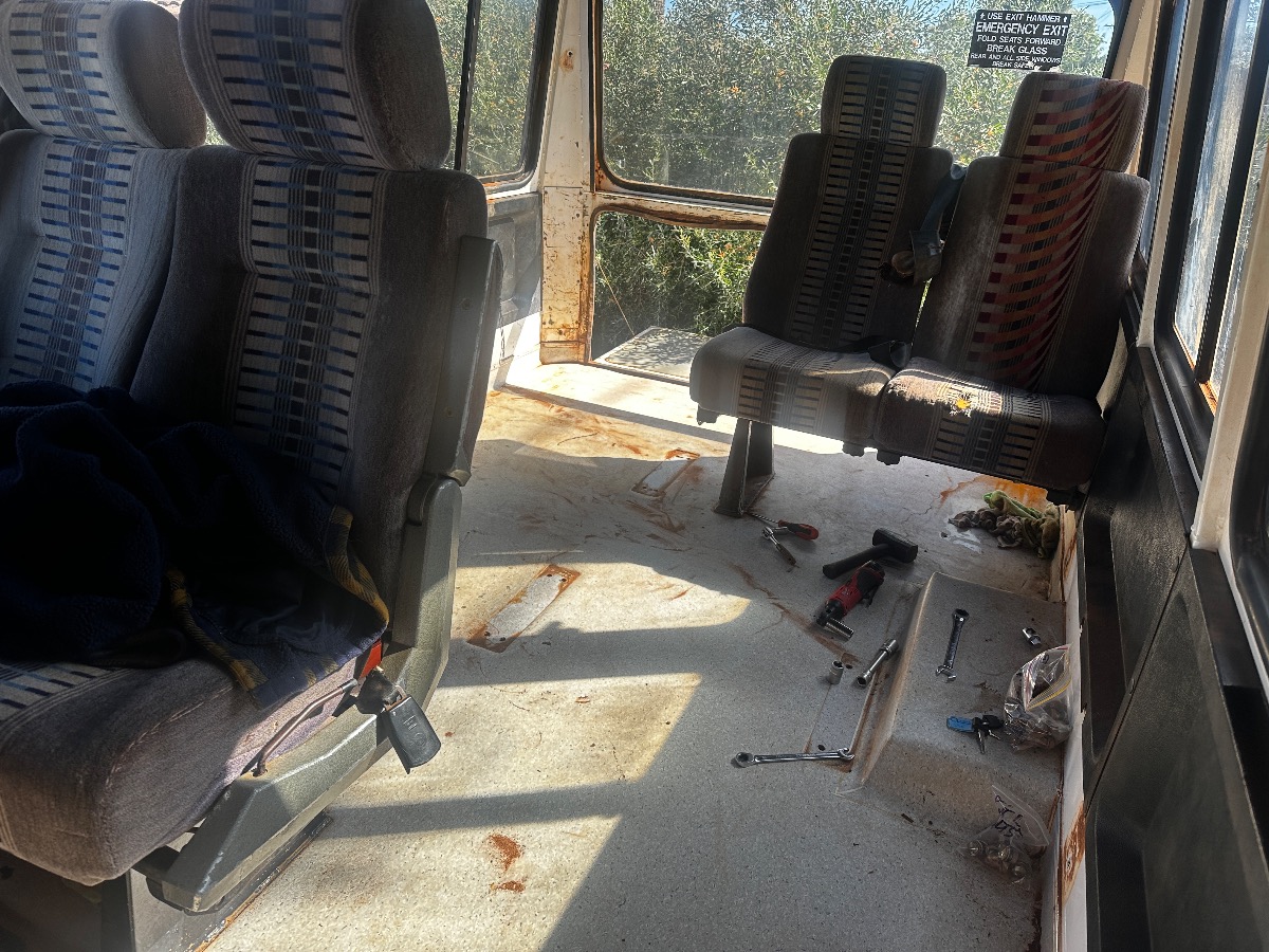

Finally began to remove the bus seats today, and wondering who came up with the idea to bolt them down using nutserts! Every 2nd one spun the nutsert while trying to undo the bolt. Prick of a job when doing it by yourself and trying to use vice grips from the bottom to hold the nutsert.
Anyway got there in the end.
Will begin undoing the bus body bolts tomorrow.
