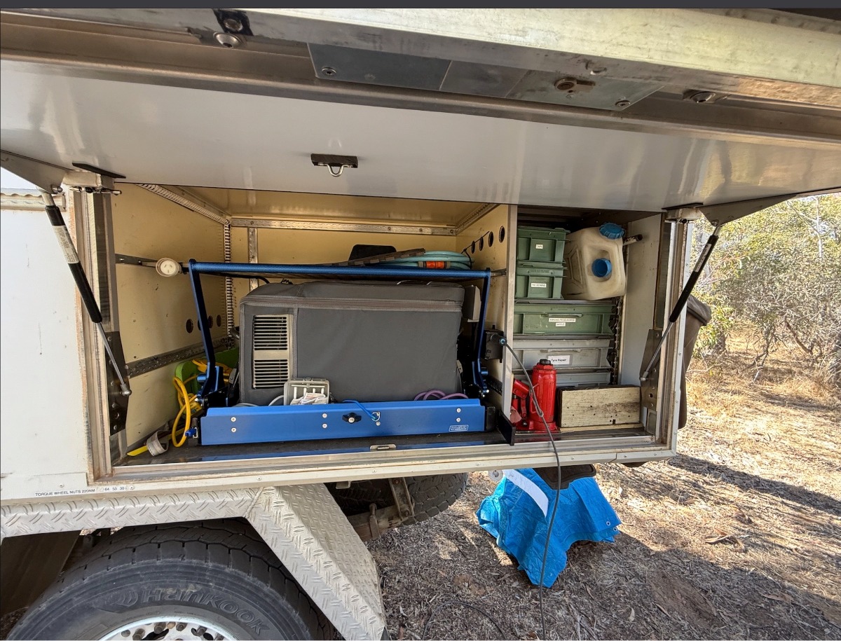

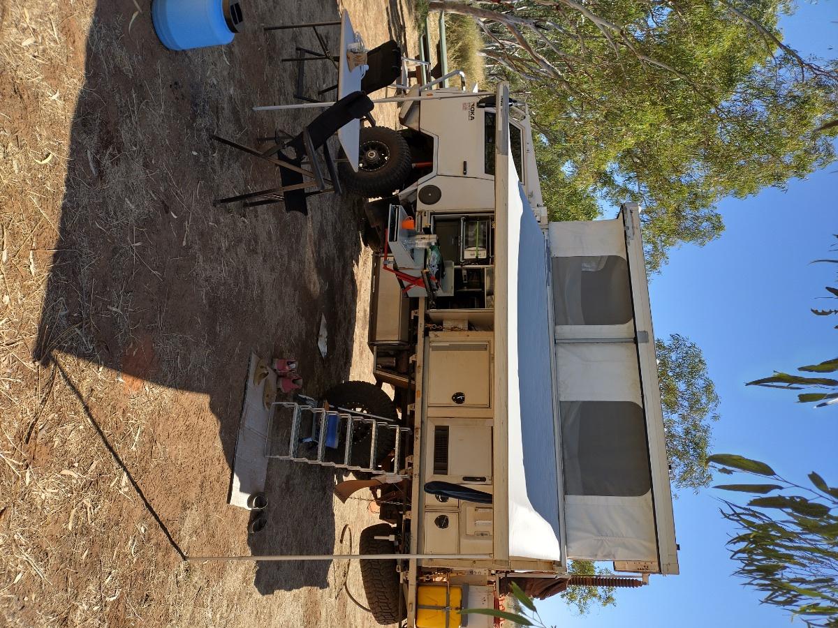

For 297 I went with a "clearview" drop down unit mounted inside the composite box under the slide on camper.
Our requirements are similar to yours re height issues etc.
To be honest I don't exactly like it because (a) it's heavy (b) requires to be mounted on one of their fridge slides (more weight).
Given time (didn't have) I would have made one for less weight and better functionality, but there it is.
Sorry for crap pic am currently overseas and this is all I can find.
Cheers!
Dave
Cheers!
Dave

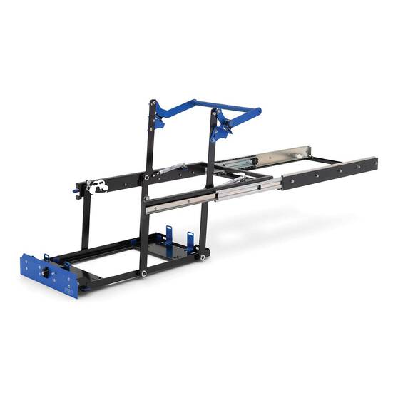

Thanks mate. Yeah I have seen loads of fridge units like this, however could something be rigged out of one to hold a kitchen?

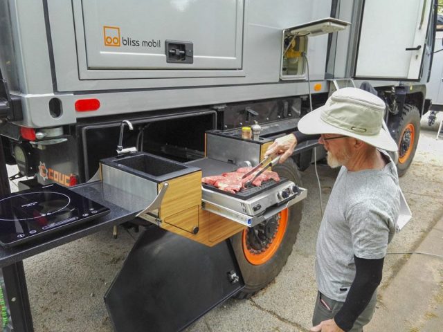

Sorry to clarify - by "kitchen" I'm not referring to a fridge, but rather a cooktop (gas or electric induction) with 2-3 burners/plates, and a sink with running water (and a place for it to drain). The fancy one in the pic above is (I think) on a Mog, and still looks too high. The sink is also an afterthought by the loos of it!
We use a plastic folding table for prep, so bench space no big deal.
The challenge is:
- an outdoor cooktop next to a sink with running water at standard bench height.
- under an awning
- easy pull out/pack up (ideally no need to connect/disconnect water and power +/- gas every time)
- can then arrange outdoor cupboards/drawers (or integrate with kitchen) so everything is nearby
- nearby fridge at reachable height also ideal (perhaps an upright so height less of an issue?)
Man! Not easy on a tall vehicle! Mat
The challenge is:
- under an awning
