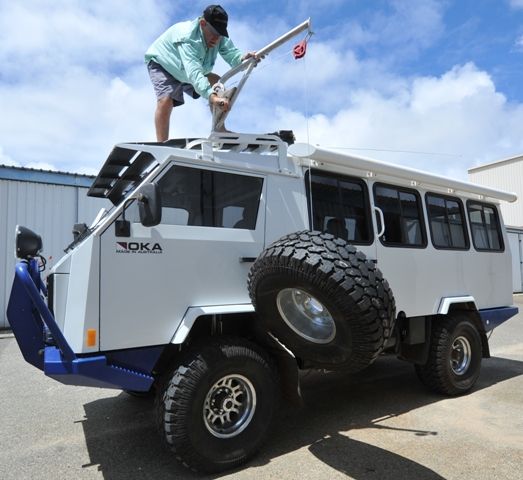

We also added an aluminium sun visor identical in design to the original steel one, and an aluminium rack over the cab to take a spare tyre, Hi Lift jack and four MaxTrax. Both are powdercoated. The small 55W Hella rectangular high beams have been replaced with IPF high/low 110/80W QH headlights.

The full-size spare lives on the roof rack (there is a removable aluminium derrick and winch for the up and down bit) because it's a bit too snug under the back; and should anybody else consider doing the same tyre fit, be assured 38.5" is as large as you can go without a body lift!
