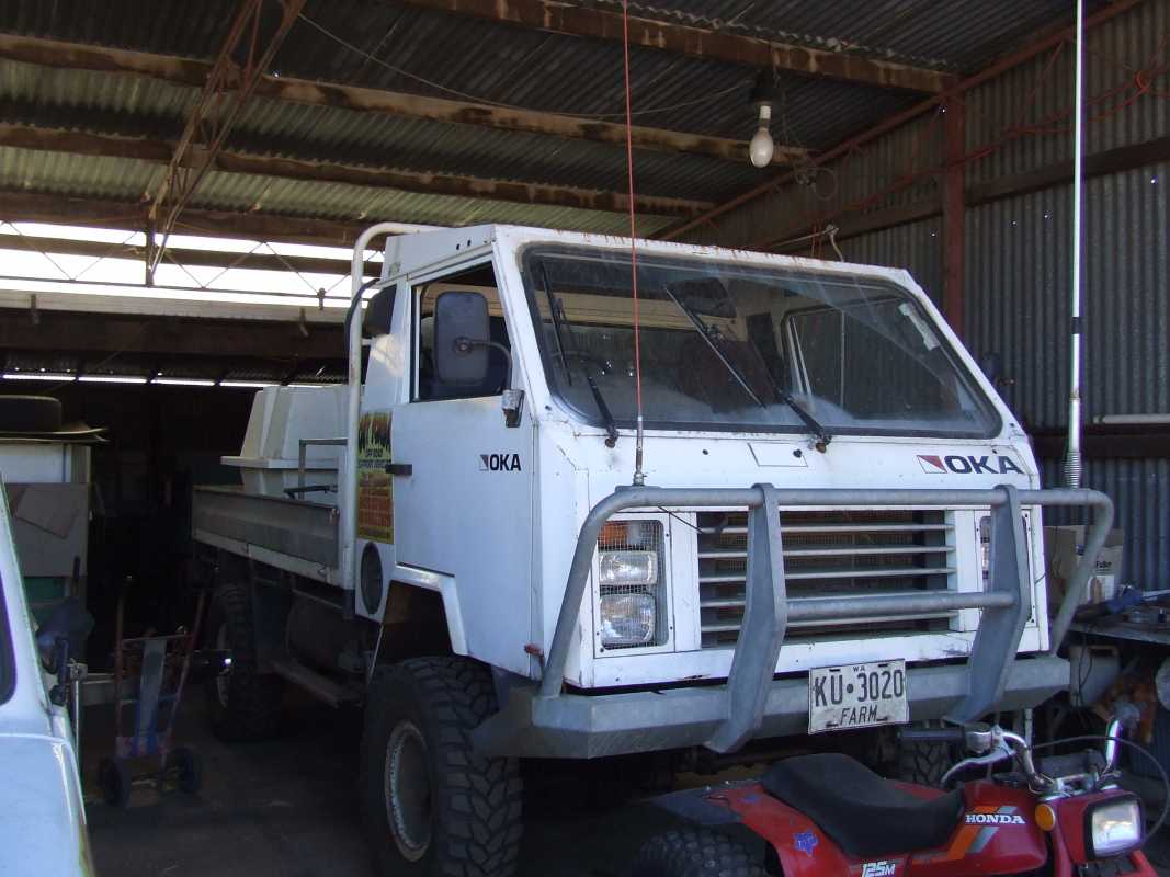

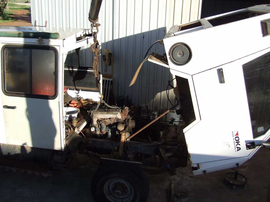

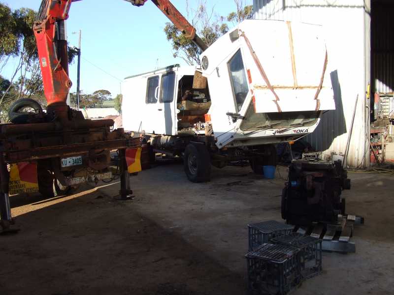

With OKA Parts Australia.eventually we will offer 6x6 conversions.
In front of me is desijn engineers certificates
A D R , brake tests & plenty of buracratic bull---t.
I have done it all befor, just takes time, lots of it.
part of the refurbish is a 6bt cunnins auto & body work.
Brett

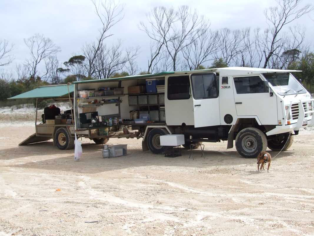

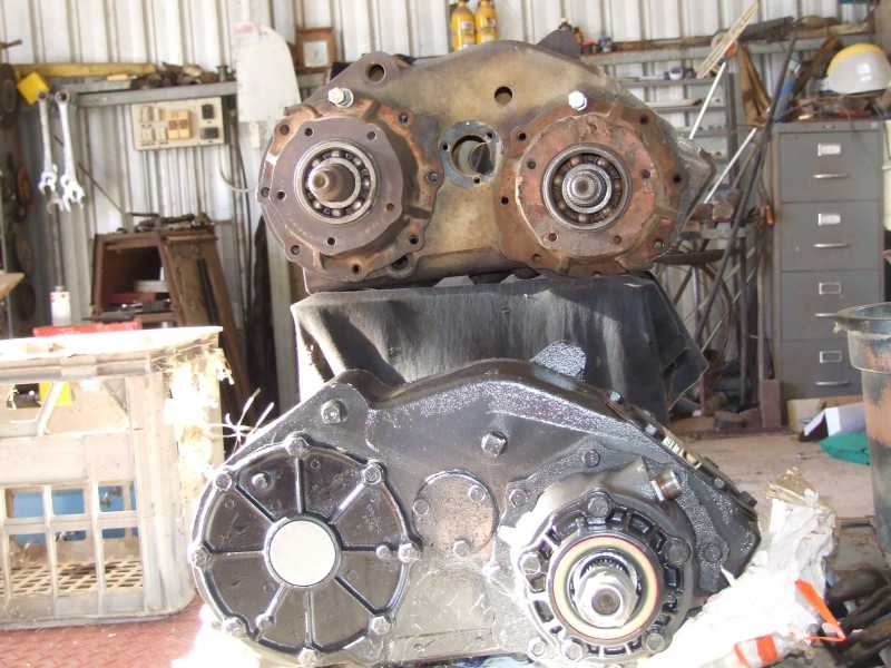

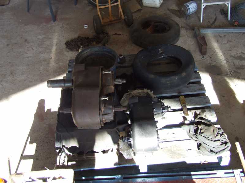

Maybe i missed it, but:
- what donk are you putting in it? You're surely not going to expect the old Perk to haul 6 wheels are you?
- What's the overall length extension to the chassis with this mod?
- How do you select between drives? the other rear output is rear of the front output, does the front only engage in low range now?
- What's the increase in GVM?
Cheers, Alister
- outyonda
- Posts: 780
tyres; with the correct tyre hight, width & rim spacing the tyres don't scuff out.
donk; at the moment the perk is doing the job ok, easier than a trailer. 6bt in the plan.
length; 1200mm to 1600mm max.
drive; the drive system is a Brett special, the secrete stays with me.
