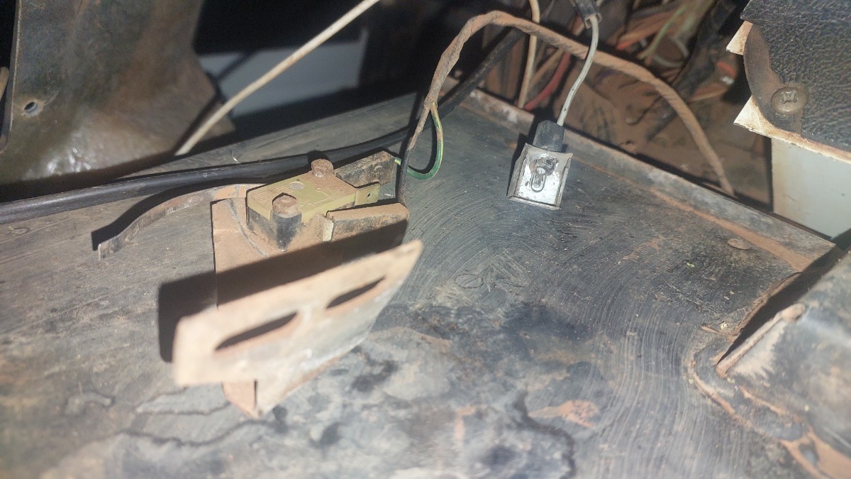

1995 LT
Fixing the heater - air direction - air recycle - fan assembly and found a micro switch with bracket and a small light in a metal box.
I have a microswitch for the demister
Where do they belong?
Whoever took this apart had no idea so I spend time working it out but this has me stumped.
If you have photos of the workings of this area it would be appreciated

Peter and Sandra OKA 374 replied the topic: Where does this belong?
4WD indicator light, sits near the transfer case lever box and gets operated when you move the transfer case lever from the 2wd position.
They were also used to indicate the side door was open and the step was down but ours never had one.

16 Apr 2025 20:22 #3
by peewee65
peewee65 replied the topic: Where does this belong?
Any idea about the little light?
17 Apr 2025 04:08 #4
the little light would plug into the back of the appropriate light on the dash. The bracket on the switch is roo big for the 4wd indicator mount so suspect it is the step down indicator/

17 Apr 2025 19:56 #5
by peewee65
The light has a metal box open on one side. Looks like it has broken of but I can't see where
18 Apr 2025 05:27 #6
The indicator lights on the dash have a lille box on the back..
