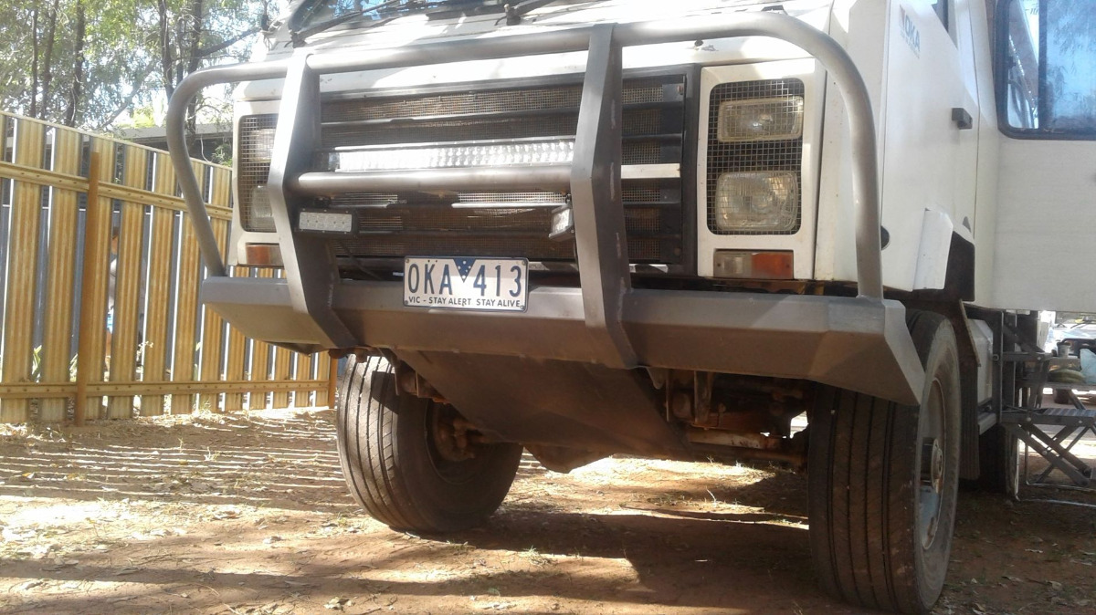

The Oka steel bull bar weighs in at approx. 80 kg and is cantilevered approx. 1 metre in front of the front axle so has been removed and replaced with a 'temporary' bumper of light weight purlin which weighs approx 25 kg to be replaced with an alloy bar of similiar weight.

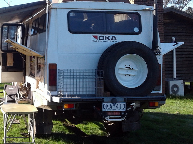

The incredibly heavy rear tailgate was given the flic with rear 'under bed access' now via an additional access door behind the rear axle on the drivers side.
A replacement 12000 lb. '4WD Supastore' winch with Dyneema rope in a de-mountable tow receiver cradle (32 Kg) now lives under the spare wheel.
In practice the the rear 'purlin' and replacement rear panel/supports/winch mount is at worst 'weight neutral' with the removed tailgate.

The rear tailgate is now gone which means it's easy to carry a spare on the back without the standard Oka (weight is no problem) horrendously heavy and cumbersome wheel carrier.
This is made from a length of 300mm purlin bolted to the tops of the existing small bumpers with bracing extending down to the sides of the same bumpers. Additional bracing extends down to the winch carrier and transfers the weight of the spare wheel(s) to the tow bar. The number plate is mounted on these straps/bracing. The frame inside the new rear panel has three verticals of 50mm RHS so that one or two spares can be carried/stayed in whatever configuration ie. left or right, left and right or centre only mounted as required. Note that the wheel(s) weight is transferred to the tow bar so the rest of the carrier/mount can be of comparatively light construction when compared to the original Oka heavy weight monstrosity of single/dual wheel carrier. The mesh cage on the LHS is for firewood.

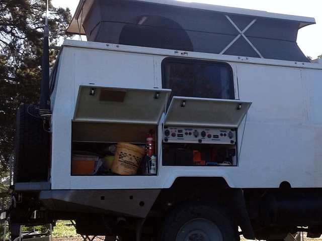

Access to the rear (under bed) storage is now by matching (to Kayes LHS kitchen) access door. The other access door is to a bin/storage area N70 battery deep, approx 330mm, and the same height as the rear hatch. The switching panel is only 50mm or so deep so it doesn't impinge on interior storage.
In the bottom section on the left is two 100 ah LiFePO4 batterys from Low Energy Developments in Melbourne bought on ebay when on 'special' for approx. $325 each. Current price is now double that. The orange unit next to the batterys is the 58 volt charger for our AEG electric chain saw. The blue unit next to this is a Victron 500 watt pure sine wave inverter to power the charger and the red Milwaukee charger in the rear RHS corner. Behind the inverter is the main transceiver unit for the Codan HF radio. On the right hand side of the storage bin is the Votronic solar regulator and DC-DC charger for the Lithium batterys.
The switch board above manages power in and out to run the house and other electrics.

Bullbar weighs in at less than 30 kg which is a huge weight saving over the original which is more than double this weight.

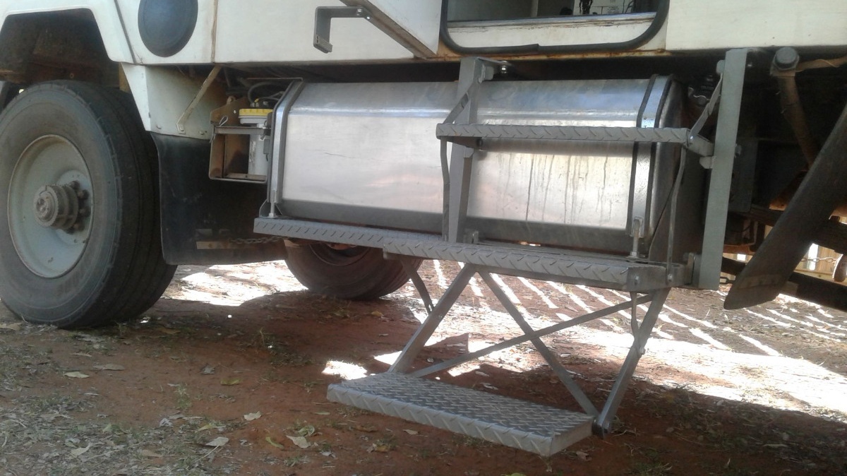

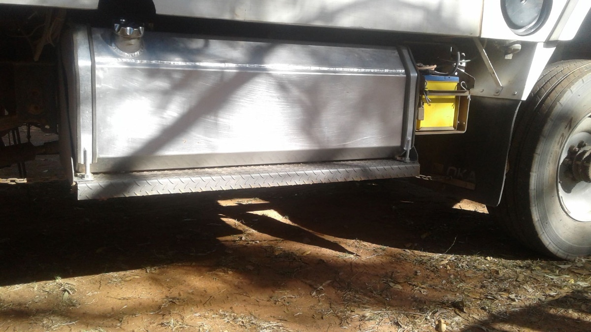

The fuel tanks are made from 3mm aluminium are baffled and fit in the same space as the original 105 litre tanks with new mounting brackets and with an additional mounting point for added strength. There are a surprising number of variations in Oka fuel tanks so although 'one size may fit all' there are differences in filler positioning and pickup/return/vent fittings.eg. #413's LH filler positioning is a bit different due to the bus door relocation and the RH tank has an additional pickup for the diesel heater. Chris makes these in either aluminium or steel, whatever 'rows your boat'
The piece d'resistance though is the replacement foldable 3 level step. It's an ingenious design which folds neatly and is held in place with a bracket mounted on the bottom of the door. ie. with door closed the steps are held in place without further ado
Chris's design and attention to detail is second to none and I can recommend these to all Oka owners.

Dean and Kaye Howells wrote: #413 now sports a new aluminium bull bar, dual 160 litre aluminium fuel tanks and replacement steel steps. All were pre ordered and provided by Oka Chris in Kununurra.
Deano
How good is the bull bar?
What size bolts hold it on?
