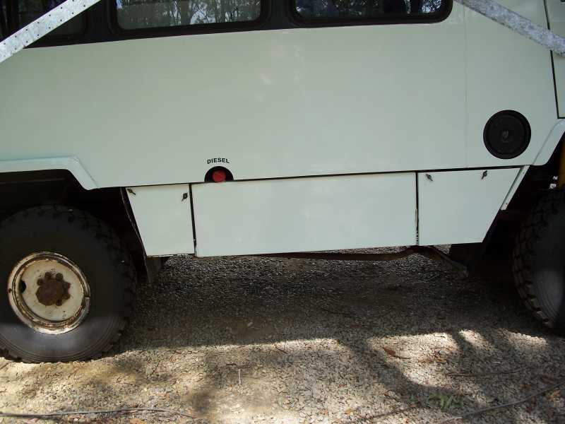

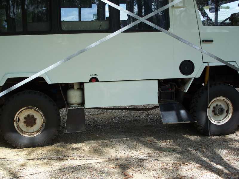

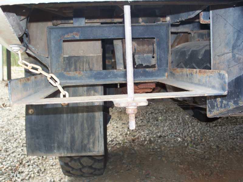

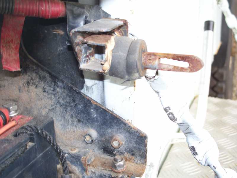

24 Nov 2012 14:21 #11 by Paul and Sue Crompton
Paul and Sue Crompton replied the topic: Fuel Tanks
Hank, I think my dimensions work out to be about 190 for each tank and an extra 40 litres at the rear in gerry cans if required. I have found the front tanks to be more than ample capacity for my travels. Generally, I only take advantage of this if I am driving long distances and I don't have to stop at the more expensive fuel stops. If I was building again, I would only go for a similar size as I find if I am staying out in the bush for some time, it is not the fuel that is an issue but being able to carry enough water is more of an issue. The only track I can think of that you would need much larger capacity is the Canning and even then you can usually get fuel along the track at communities. As far as finding places for your batteries, I have more battery space behind the rear diff. Please feel free to email or ring me. Hope this helps. Below is a rough sketch and some photos (the pink indicates the triangle support brackets, one on each end is all I can see). Paul.

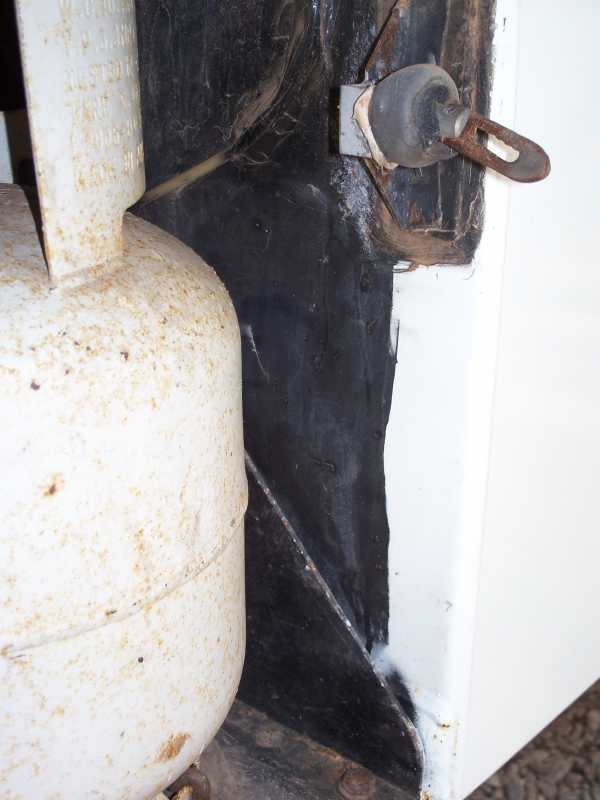

File Attachment:
File Name: OkaFuelTank.pdf
File Size:618 KB
Right side, battery front, gas bottle rear
Actual tank (spade underneath)
Rear triangle mount which goes up to chassis & wraps around with another triangle
Front triangle welded directly onto chassis, few inches higher than bottom of tank (reinforcement plate welded on tank)
Provision for steel gerry cans behind rear mud flaps on each side, hinged from front of holder
Paul Crompton - OKA 168
